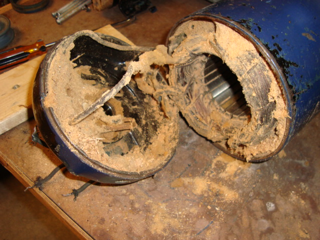

This bench saw was given to me by a friend who got it from his grandpa when he passed away. It sat for quite awhile, and just recently I put all the parts together (table extensions, etc.) and got the motor working. The table insert that was with the saw may not be the original - had to cut and file the opening so the saw blade would clear. Unfortunately, the arbor cannot be tilted all the way to a 45 degree angle as it hits the insert, hence my thinking this is not an original insert. (Would love to find original inserts for it; a total of three, I think - a kerf, dado, and sanding insert)

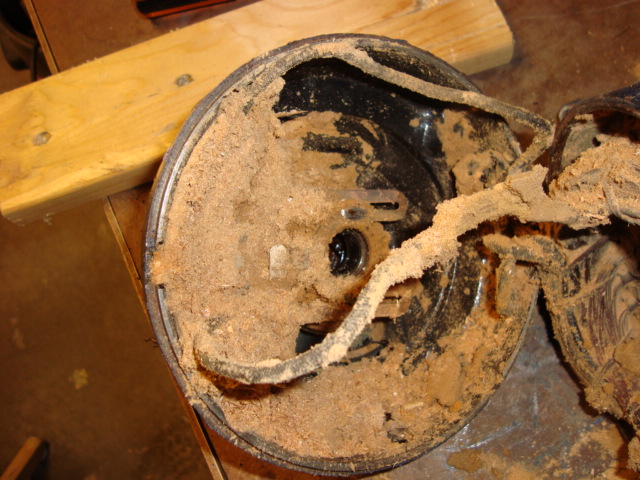

1HP GE Capacitor Start Motor - Evidence of many, many years of use
CDSmith, Owner

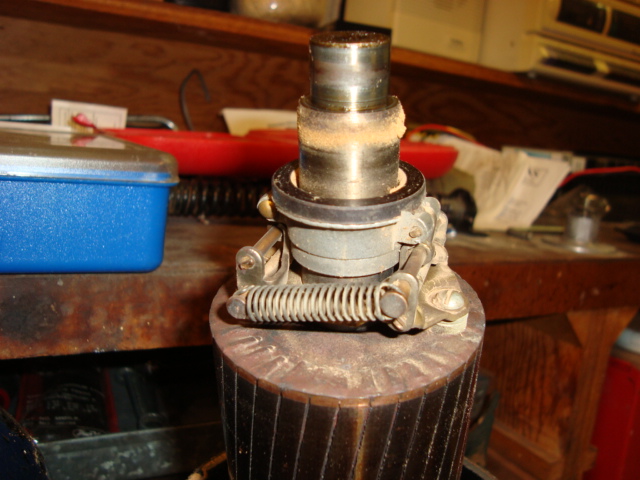

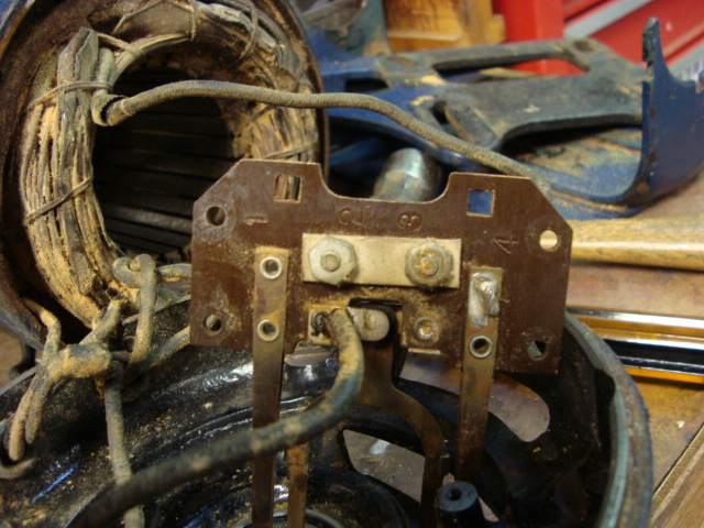

1HP GE Capacitor Start Motor - Centrifugal switch barely visible
CDSmith, Owner
1HP GE Capacitor Start Motor - Mechanical part of centrifugal switch in good shape
CDSmith, Owner
1HP GE Capacitor Start Motor - Centrifugal switch cleaned and inspected; switch checked out okay
CDSmith, Owner

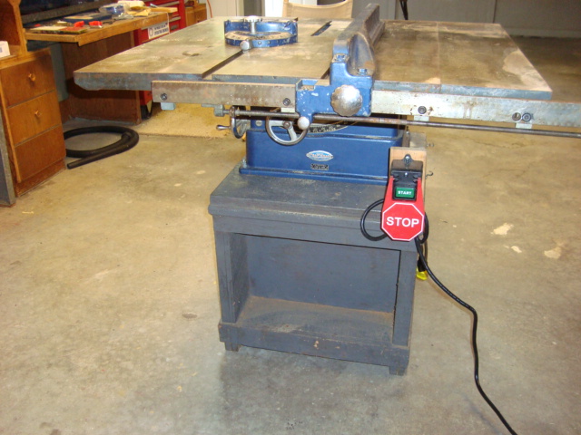

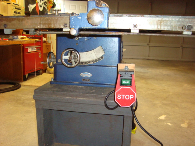

New (and safer) switch (from Rockler) installed / Saw base built by my friend's grandpa
CDSmith, Owner
