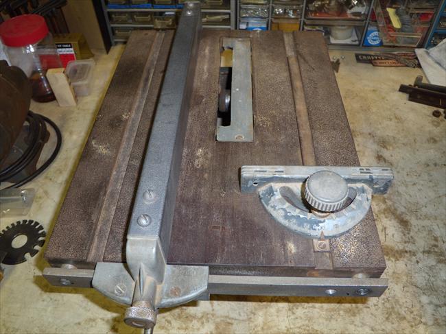

As received

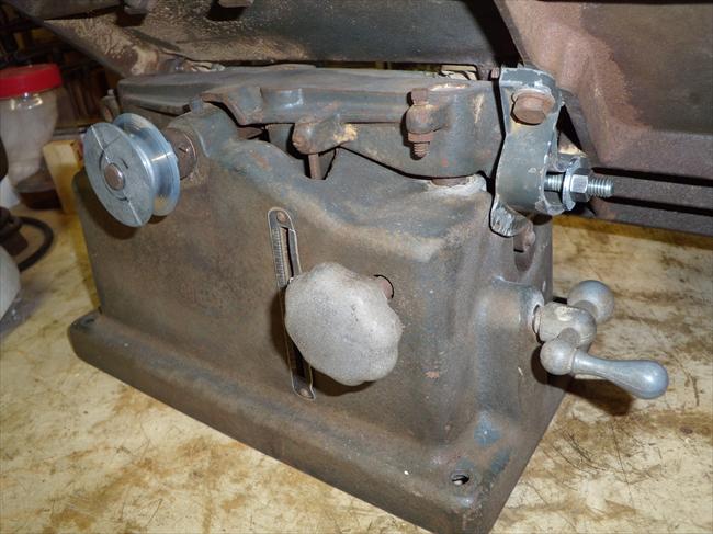

Tilted top

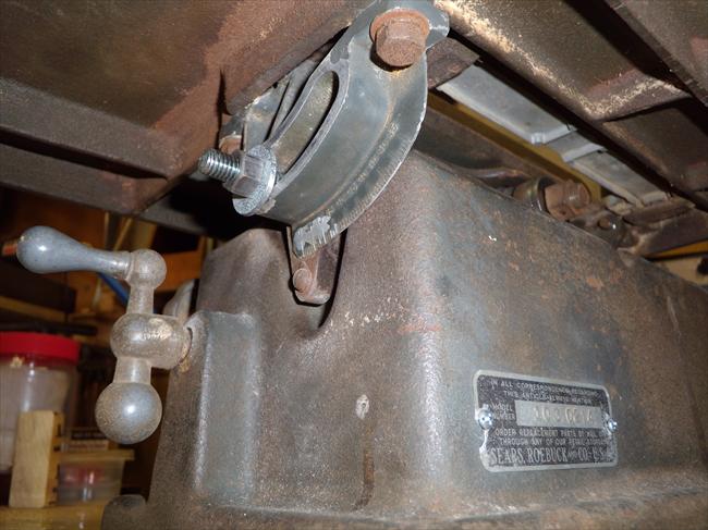

Tag, elevation crank and tilt protractor

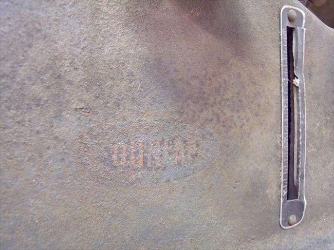

Elevation scale and Dunlap decal

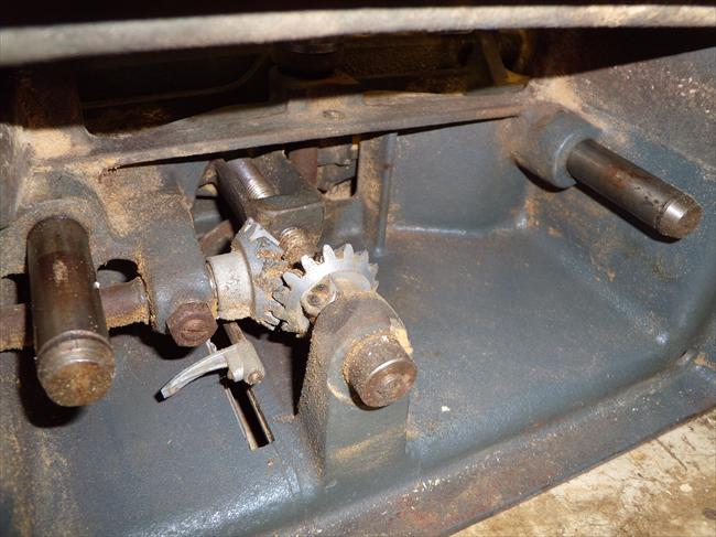

Elevation mechanism and scale pointer

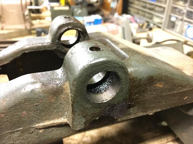

Pressed out Oilite bearings to show oil reservoir channel around each bearing.
