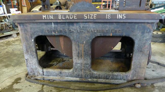

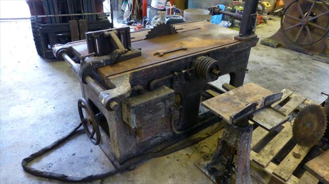

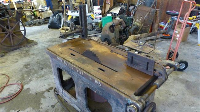

Minus a couple of key parts on purchase, the crown guard and the fence plate. I have a spare Sagar crown guard of about the right size, and another saw here with the same fence design to copy the missing plate from.

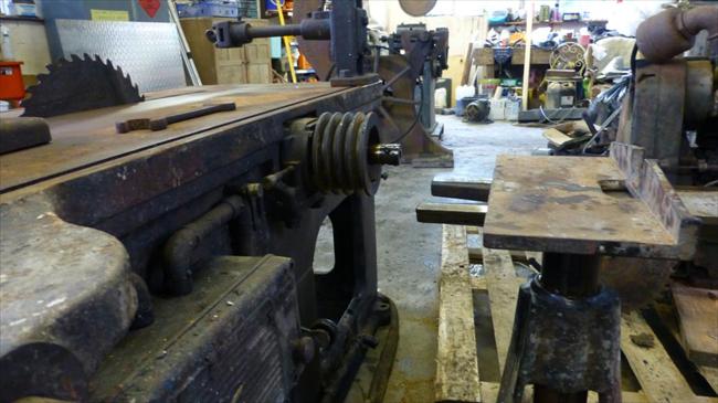

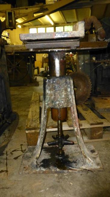

I was most taken with this saw because of the horizontal boring attachment to be fitted on the floor at the far end of the saw shaft, the end of the shaft has a hole bored in it and a grub screw to grip the tool, and the boring table is free to move in and out freely, no lever control, stops or anything like that, just as simple as it can be. Its a stout thing though.
The saw also came with a couple of Sagar spanners found lurking nearby.
I think there is original paint under all the paint splashes, i wonder if they could be removed?

The horizontal boring attachment.

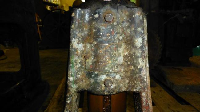

J. Sagar brass badge just to be made out on the boring attachment under all the paint splashes.
