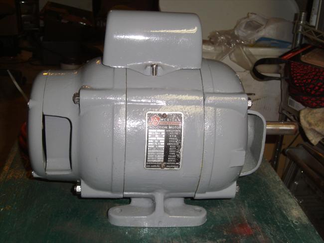

I got this motor as a part of a free deal on a Craftsman 1939 table saw. I saw the ad on CL so called the man in Lincoln. He said he was just getting rid of it, so I told him I'd be up the next day. I drove up and after a little GPS navigation found his house. He already had it in the Garage. Getting it in the back of the truck was a trick as it was on a steel table and that saw and motor are all cast iron. Probably 150# or more.
He said the saw was his Dads and the motor ran until about a year ago. Then it started having problems starting, until is just wouldn't start at all. So we loaded it, I thanked him profusely and drove to my storage area to unload. I pulled the saw off the table, and pulled the motor off the saw. Put the table and motor back in the truck and headed home.

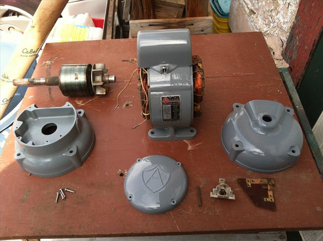

A few days later I pulled the cap cover to see what size cap it had. Found one at Graingers and ordered it. Only took a few days and I found I could pick it up locally. Never knew we had a Grainger store in Omaha. Pulled the old cap, and just clipped the new on on to see what happens. Sure enough, she started right up and ran for a few seconds, then blew my power strip CB. So, I figured it was worth the time to tear it down and check it all out. Once I had it apart, it was obvious the bearings were shot. So I ordered the bearings, degreased, cleaned, striped, primed and painted the entire motor. I ordered the bearings from Grainger and got them in two days.
I re-assembled and nothing but a hum. I had clipped the start winding wire between the case and endbell when I put it back together. So a splice and put it back together again, hooked up the cap and a new power cable. Plugged it in and it ran smooth as silk. I am very pleased with how quiet it runs and how smooth. They just don't make them like this any more.
It was great fun doing this restore. I learned a lot about dual voltage motors, and the wiring. The wires were not labeled and I had no way to match the wiring diagram on the motor. So I used my multimeter to ohm everything out and connect the windings in parallel. I was lucky it ran as it should.
This is what it looked like You can see the new cap in the box at the lower right.

All cleaned, painted and ready. Just need the bearings
