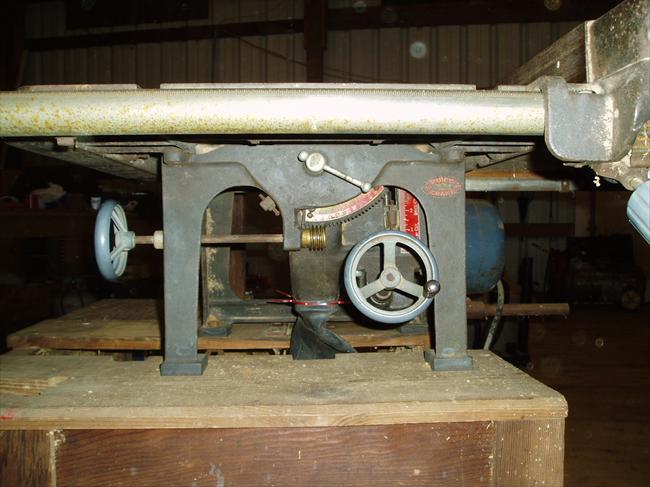

Purchased several items at estate sale about 4 years ago and the table saw was one I wanted. I didn't research the manufacture until January 11, 2014. The blade lift was not working and I wanted to fix it because I wanted to use the saw for woodworking in the barn. I found this site and read other information about the saw. The floating nut threads on the lift spindle was bad. I took the lift mechanism and floating nut to a machine shop. An older Machinist was familiar with the saw and knew how to make a new floating nut. I reassembled the saw and took pictures to upload to the Vintage Machinery
Underside of table
Picture taken in barn
