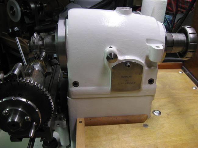

Headstock-right side.
My Canon Powershot A590IS

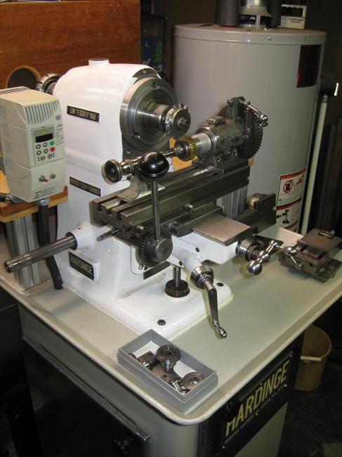

Right side overview.

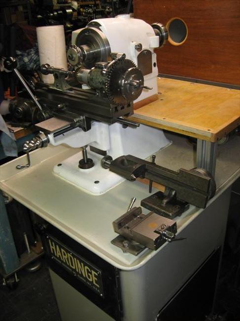

Left side overview with V.F.D. controler.

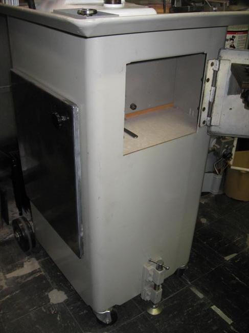

Modified cabinet so it could be wheeled around. It's really heavy!

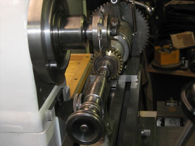

Set up for cutting straight spur gears.
