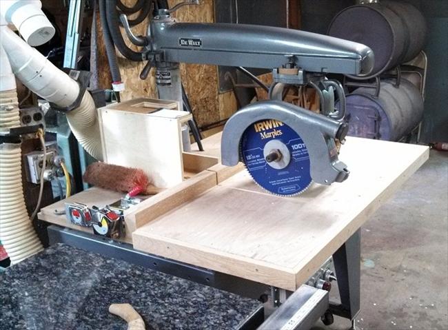

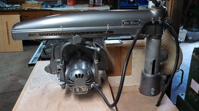

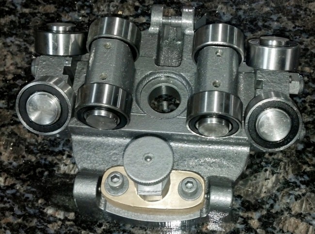

After restoration the saw runs perfect and cuts perfect. I had to replace all the carriage and motor bearings. For the restoration I removed everything, bead blasted, filled the castings, and repainted everything. Redid the table and added dust collection. Right now it has a 12" blade.

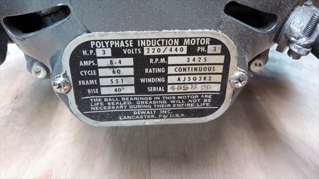

This GR has the 8 bearing carriage as seen below. It seems that many of this era had the conical four bearing carriage. From what I have seen, all the 3hp and greater, 3ph motors have the 8 bearing carriage.
Comments: Dewalt 14" 1950 RAS after restoration

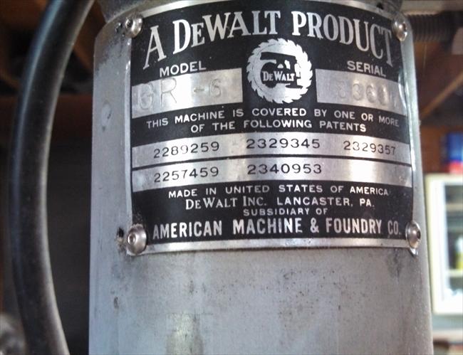

Comments: Dewalt 14" 1950 GR-6 serial tag 83683

Comments: 1950 14" GR motor tag, 3HP motor

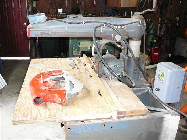

Comments: 1950 Dewalt 14" RAS before restoration

Comments: 1950 DeWalt 14" RAS 8 bearing roller head after restoration

Comments: 1950 DeWalt 14" RAS after restoration
