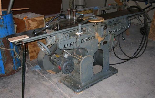

A Craigslist find. Originally sold in LA CA by Smith Booth Usher Co. Machinery Merchants of San Franscisco & Los Angeles. Ended up in Las Cruces NM. Previous owner had a machine shop in El Paso Tx bore out the babbit and installed ball brgs. Also had a motor mount kludged onto it and a single phase Baldor 2HP 3450 RPM installed. Twin V belt drive & and somewhere a air compressor is missing it's belt shield. Also has one broken table adjuster bracket. Fence is complete, still has the original 2 knife cutter head. Missing the pork chop & mounting bracket, has a home made replacement. Needs some TLC but for this area it's a rare item to come up for sale. These things are heavy for a skinny old guy to wrestle around.
Fits in the door
