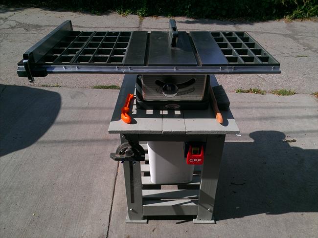

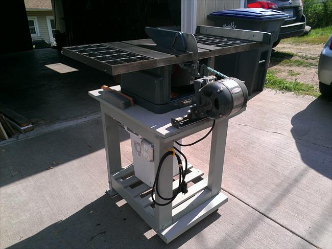

I picked this up a few weeks ago at an estate sale on half-price day for $22.50. It was fully functional and complete with a single table extension, fence, blade guard, miter gauge and custom table/cart. In addition to a decent cleaning:
1. Purchased two additional table extensions and fence rails from eBay.
2. Installed a Vibration Free Link Belt purchased locally from Harbor Freight.
3. Installed a Freud Diablo 8-1/4" blade (with 5/8" arbor hole) purchased locally from Diamond Drilling.
4. Installed a single arbor bushing out of a $1.99 set purchased locally from Harbor Freight.
5. Installed a magnetic safety power switch hardwired to existing motor wire plus new cord/plug and additional outlets on table/cart.
5. Painted the table/cart as well as installing new casters and a "shelf" to hold a sawdust receptacle (trash can).

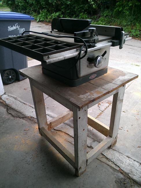

The saw's table top and extensions had moderate rust when purchased. After attempting steel wool, wire brushes, and naval jelly I finally thought of another approach: 220-grit black oxide and a 5" random orbit sander which worked quickly and thoroughly. I did, however, continue to use a wire brush on the painted parts of the extensions, which cleaned them up nicely without damaging the paint at all.
I am literally so impressed with this saw that I am now looking for more vintage machinery to add to my growing "shop".

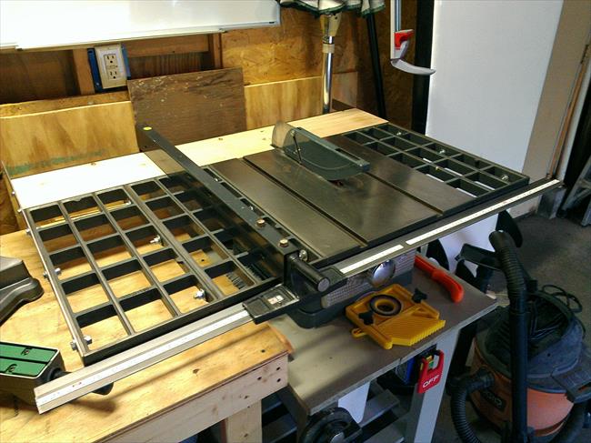

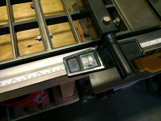

UPDATE: I purchased a "newer" Craftsman fence at a garage sale for $2.00. It simply mounts to an L-shaped metal bar, so I picked up two lengths of angle iron at my local store plus one length of square tubing as a spacer and made new rails. This fence is so much better than the "stock" one for this saw. It is deeper and taller, holds much tighter and stays square. I added some adhesive measuring tape to finish it off.
