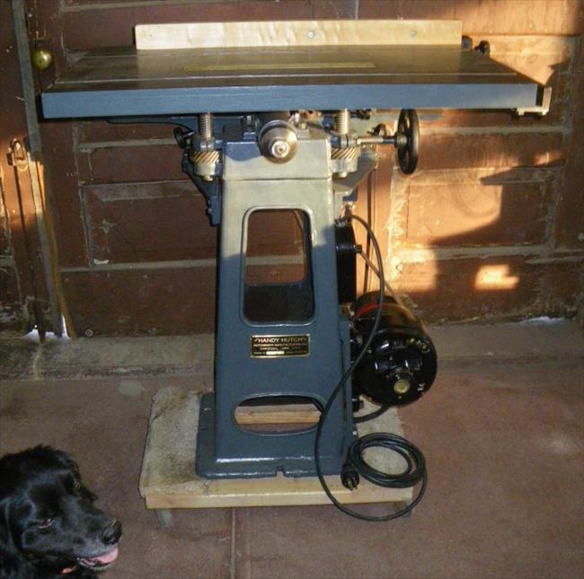

1931 Porter-Cable/Hutchinson catalog lists this machine with a tilting top as a standard feature. This machine, serial #844, has a fixed angle top, so it is likely older.
Comments: Left side, showing the brass manufacturer's tag, and the saw arbor.
