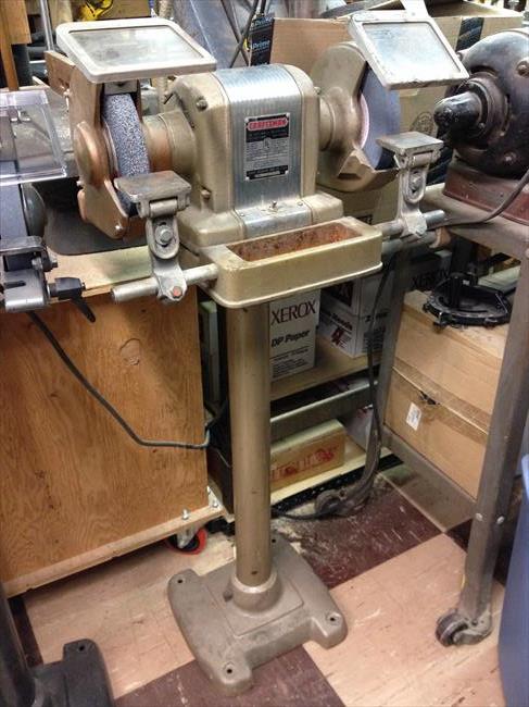

Grinder & pedestal

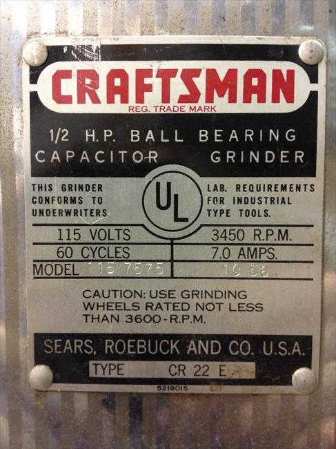

Grinder tag

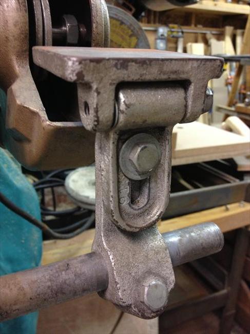

Tool rest

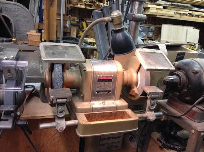

New wheels installed

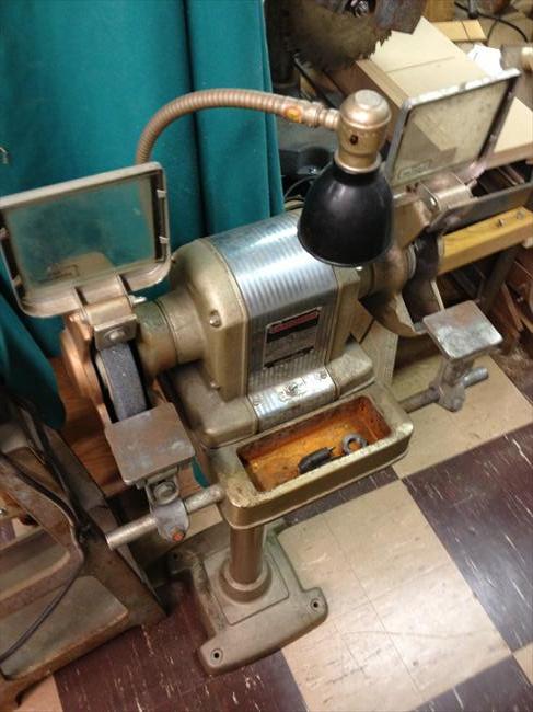

Independent lamp switch

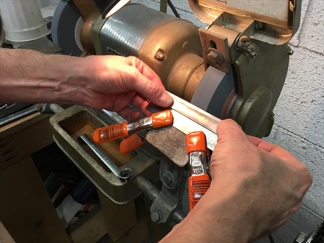

Regrinding the bevel angle on a set of jointer knives. Pony 3201 spring clamps holding a steel straight edge guide on the tool rest.
