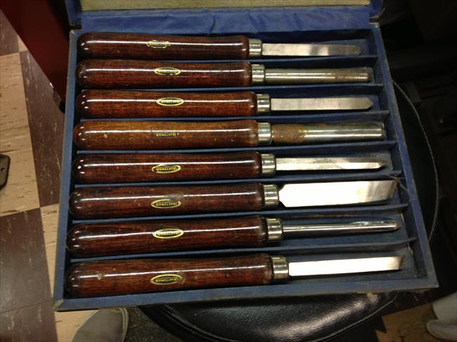

The Craftsman turning tool set is in the original box.

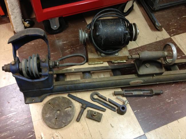

June 2013:
The lathe, accessories, motor and turning tool set are from a neighbor who no longer wanted them.
The tool rest slide was broken (appears to have been dropped).
The tailstock ram locking lever is sheared off at the casting.
The faceplate is home-made from a plate of steel and a nut welded to the back.
The motor runs whisper quiet.

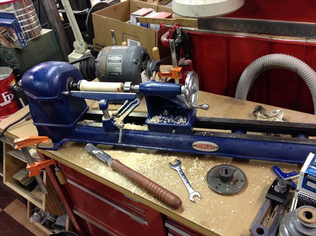

UPDATE-July 2013:
Disassembled.
Washed parts in Dawn Industrial soap and hot water.
Sherwin-Williams NOW Royal Blue #21207 spray paint.
Installed new belt and reassembled.
UPDATE-May 2015:
Temporarily clamped to a workbench and powered up with a Dunlap 1/3hp motor.
Test turning on a chunk 2" pine.
This lathe runs beautifully at all speeds--a pleasure to use.
A fellow OWWMer weld repaired the banjo.
Replaced the tailstock lock handle from my rat hole collection.

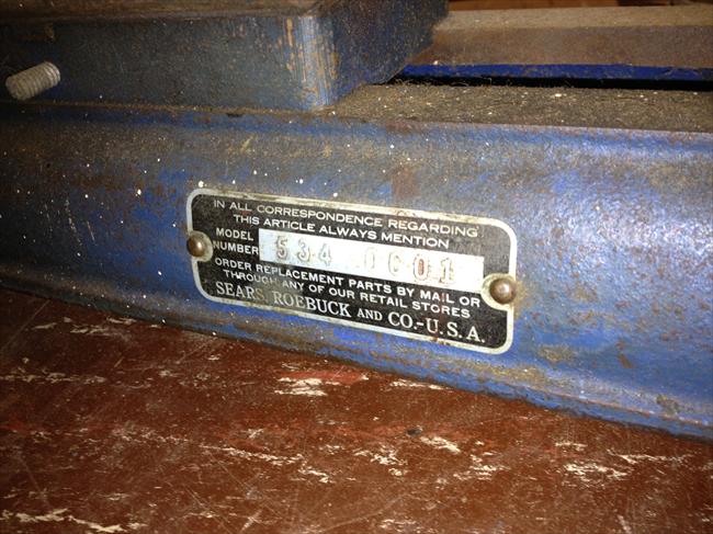

As received
iPhone camera-existing light
Tag
iPhone camera with flash

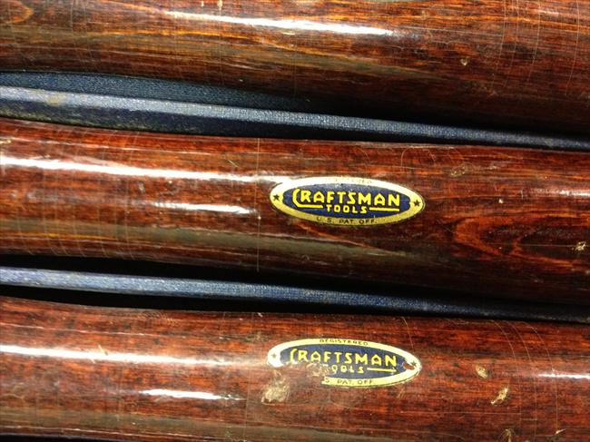

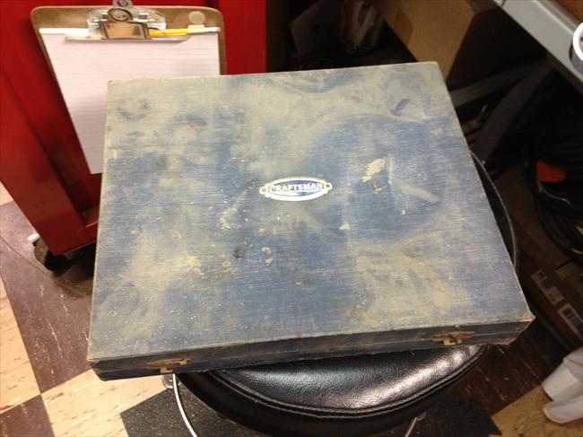

Craftsman turning tool set from the same time period
Craftsman turning tool set-box contents
Turning tool handle logo decals
Temporary set-up
iPhone 4S camera-existing light
