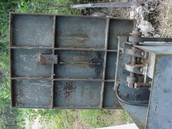

I traded a modern Craftsman table saw for it about 3 years ago. It had previously belonged to a friend who bought it from someone in Sacramento CA about 10-15 years ago. The only thing known about it was that it was once use to saw lead plate. (It still has some lead chips inside.) It had the original 2 hp. 3 phase 220 v. motor, which he replaced with a 1 hp. 1 phase 220 v. motor. The table top is hinged to the back, and made of steel. Someone in the past cut the table so that a 12" blade can be used. It has a standard 1" arbor. It had a miter gauge, which has been lost. The miter groove is the same width and depth as a piece of 2" mild strap steel. It appears to have never had a fence. It does not tilt to the side, but the depth of cut is changed by the wheel on front which raises and tilts the table from it's pivot on the back.

view under the table
self
