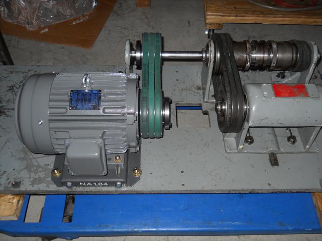

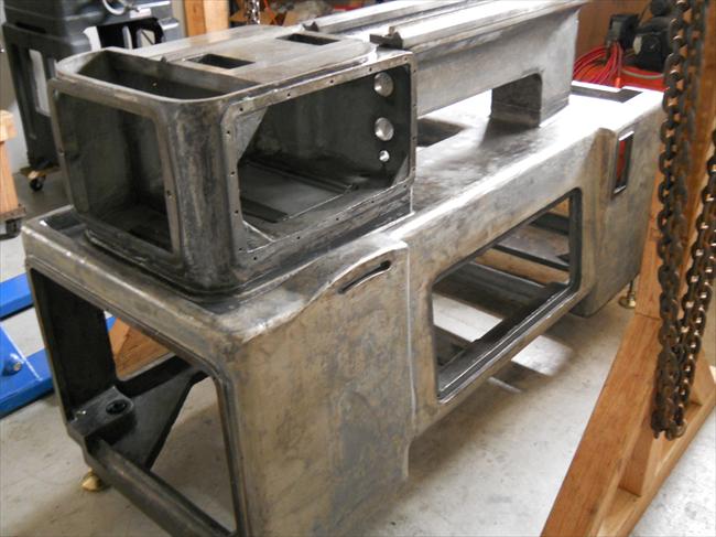

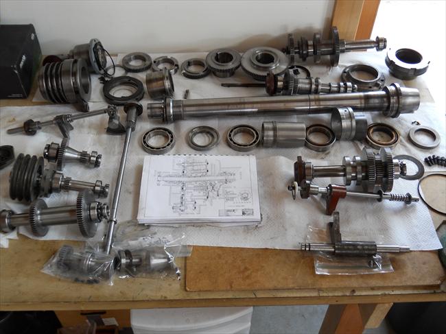

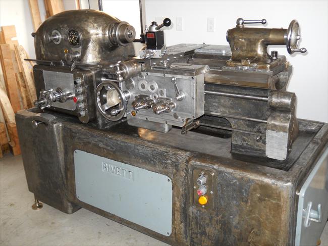

The lathe was in good operating condition when I got it. After using it for a year I decided to completely tear it down. Every nut and bolt including headstock and gearbox was disassembled. The lathe was in amazingly good condition and built like a tank. The original motor and expanding pulley system was so loud and needed to be run off a phase converter so I decided to convert it to VFD maintaining all the original controls. Runs great. Smooth and quiet. I liked the look of the bare castings so I just coated them with shellac instead of painting but for now have left the base covers with the original paint.
Comments: Rivett 1020s

Comments: New motor connected to clutch shaft

Comments: disassembled headstock

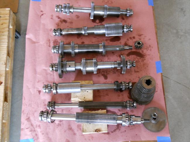

Comments: Gearbox, every shaft is on tapered roller bearings

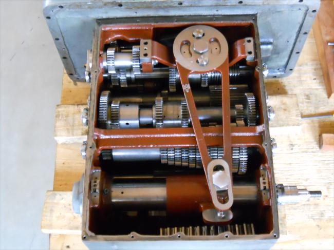

Comments: the gearbox rests on one flat and one box way. It can be slid out with one finger.

Comments: Disassembled gearbox.
