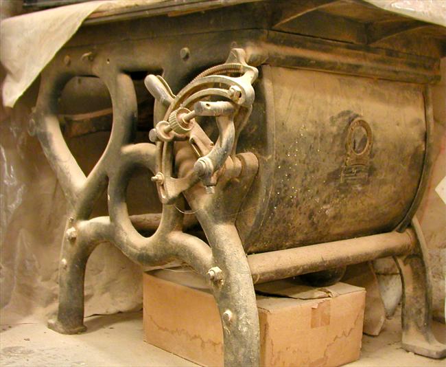

Found in the basement of Skarie Inc., Baltimore in 1991. It is the oldest Tidey saw I have seen. The logo matches the one posted here as an ad image, except that image shows "Superior Wood Working Machinery" while this one says "Superior Machinery." That could have been an error on the part of the engraver, as they seem otherwise identical to the smallest detail.
Rip/crosscut only; nothing tilts. Top raises up to access bearings. I foolishly melted the babbitt and it will need to be re-poured. I was young and stupid then; now I'm old and... well, never mind.) Arbor shaft has a series of swellings that the babbitt is poured around, to eliminate side motion of the shaft. The gizmo on the left raises and lowers the blade, and the saw was obviously made for close work because the gizmo includes a very fine height adjustment. At some point I will take pictures of the inside and post them too.

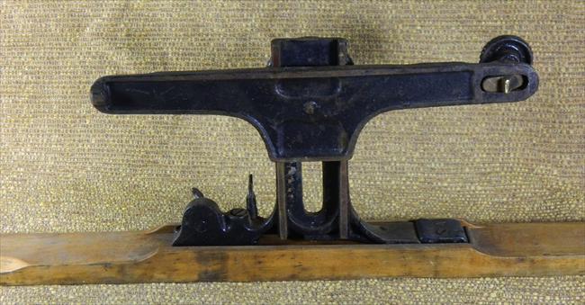

Found the cross-cut slider on Ebay. It is unmarked, but I recognized Tidey's signature design element of intersecting circles and sure enough it fits the slot, which is an odd size. Saw came with a fence that had been repaired, but I am following a listing for an intact fence. I just came back and posted the seller's shots of the fence. Looks like it's even got the factory-supplied wooden part. Seller had no idea what it was, commenting "Would make a great steampunk lamp or thing. Object d' Arte or such...." Yikes. With any luck I will reunite it with a Tidey saw at least.

Left side and Front.

Tidey Saw Fence, top
