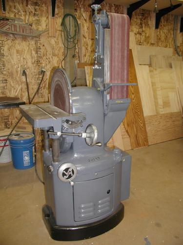

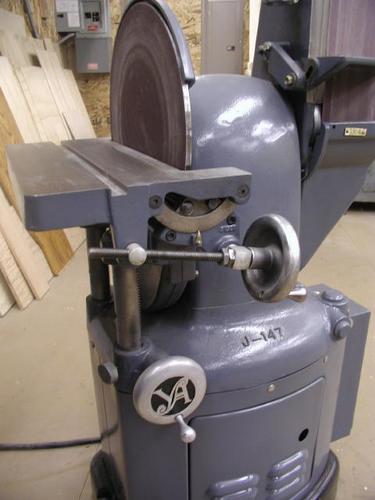

I completely disassembled the sander and spent countless hours with laquer thinner and paint stripper removing several pounds of paint. For the disc I welded up the chips that were in the rim and took it to Capitol Grinding in Salem Oregon where I met a wonderful man named Clarence who was maybe 5 feet tall and weighed all of 130 lbs. He had the biggest equipment I have ever seen. One was a Mattison grinder that had a 40 foot bed that could surface grind tables 42" wide. He took the disc and trued up the hub and then ground both sides to be perfectly flat, it turned out beautiful.

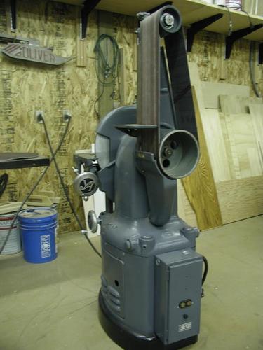

This sander is a pain in the rear to work on as everything is hard to get to. All parts were cleaned up, repainted, bearings were replaced, all the wiring was re-done. and now it runs like a champ. The disc table moves up and down vertically as well as tilts. The table for the belt is a little small. Everything else is pretty well built. It is powered by the original 3/4 hp 3 phase motor. It takes about 5 seconds to get up to full speed but it seems to have good power once up to speed. In the end this sander cost me more than I would have liked but it is a nice one.
disc side

close up

belt side
