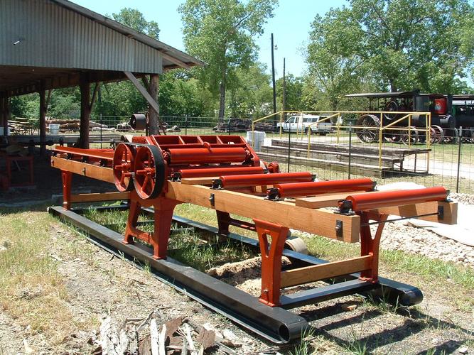

This machine was found in a scrap dealers yard. Most of the castings were there but the wood was in terrible shape. A friend of mine fabbed five of the rollers that were missing and made the skid that we put it on. I had the wood to finish bringing this mahine back to life. It took four 3x5's ten feet long to do this. I stained and varnished these and they really look great. The missing castings were sent off to be recast. It was painted and new teeth were installed. We put a belt on it and it ran great!!!
this is my edger at the sawmill at the steam and gas engine show in pawnee, ok
myself
yet a different angle

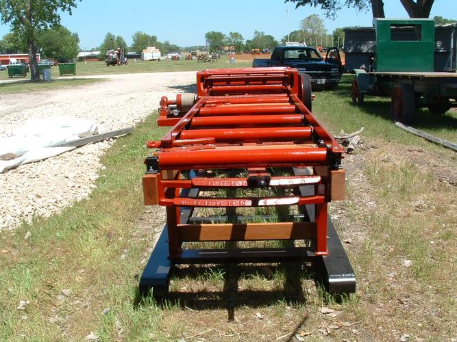

myself
a veiw from the infeed side
