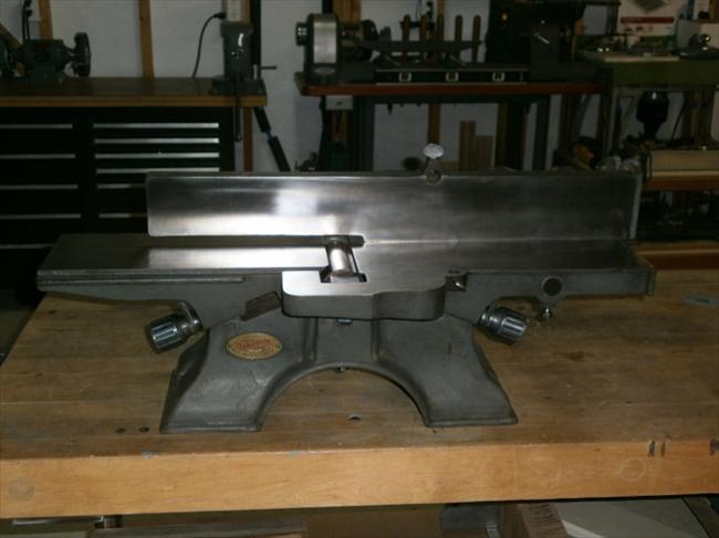

Comments: Front vew condition as found with missing blade guard and missing/broken front table knob you can see is missing in this picture.

Comments: Front view of cleaned, adjusted, lubricated jointer now in working orignal condition
