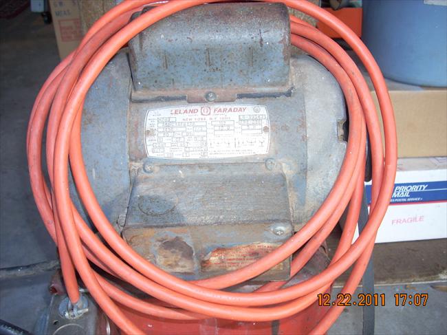

Looks like I'm the first to post a Leland Faraday motor on this site. Went through it and replaced the dried out bearings with Nachi 6203ZZE bearings. Very smooth and quite now, no more squealing. Painted and rewired. Build tag found inside motor gives a date of 8/16/79 with the motor being number 30 of 50 built that day. Came on a Delta 34-600 9" table saw, probably not original to the saw. I'm leaning towards installing this motor in a Delta 34-260 Junior Unisaw I'm restoring.
