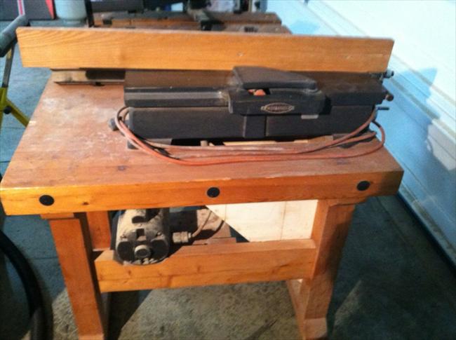

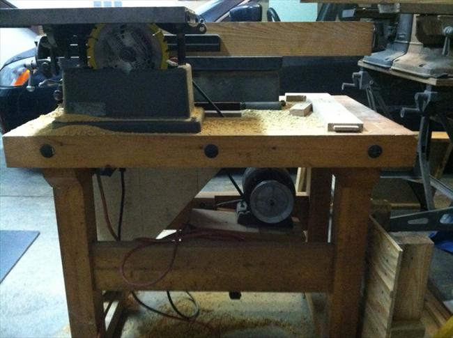

I purchased this jointer off of CL from the grandson of the original owner. It came mounter on a very nice table that provide enough room to mount my 103.0214 tilt table saw next to the jointer making a great combination machine. The grandson had reversed the pulleys at some point causing the cutterhead to run very slow. I switched the pulley on the tool to a 2" matched to a 5" on a 1/2 HP motor turning 1725 RPM producing a cutter speed of 4500 RPM. The chips really fly now.
Table with original motor
