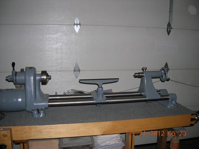

Aquired of off the list in a nearby city. Needed a complete go through. A very heavy lathe approaching 250 lbs. the ways are very thick walled 2" tube. Features a vairable drive but do not know the actual speed range. mt2 on the tailstock. threaded 1 1/2 x 8 on the head. Looking at the pics on this site it appears to be a w-20 but could also be a j-line. Has a 1/3 hp YA RI motor on it which runs smooth. If anyone has the art deco stand which it sat on would love to hear from you. Also would like to know def model no? Bob
Comments: overall
Source: my coolpix

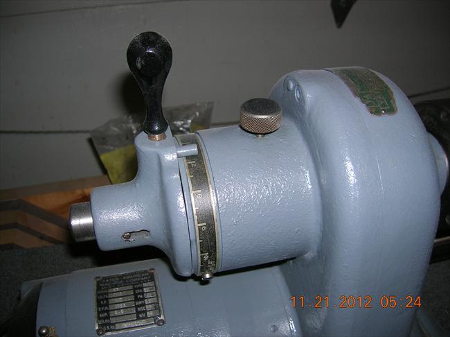

Comments: headstock/motor combo
Source: my coolpix

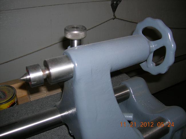

Comments: tailstock
Source: my coolpix

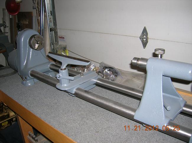

Comments: 12" tool rest
Source: my coolpix
