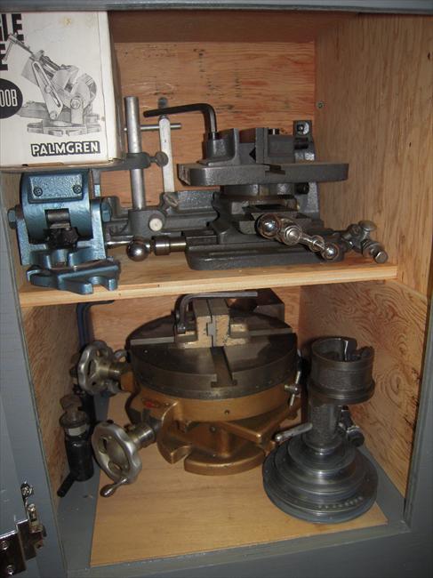

Palmgren tilt vise, Craftsman/Atlas X-Y vise, Craftsman/Palmgren rotary X-Y vise, Slo-Speed attachment for 15" Atlas.
My Nikon Coolpix with flash.
