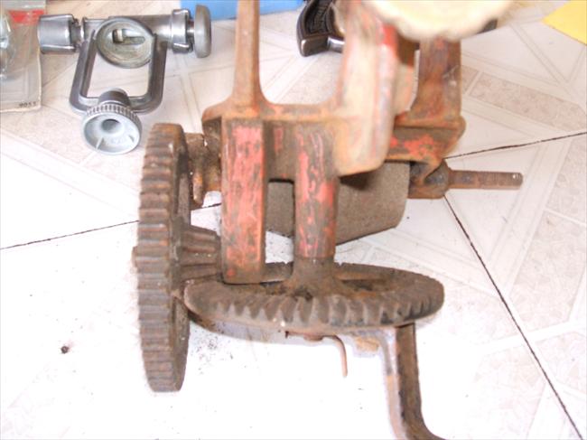

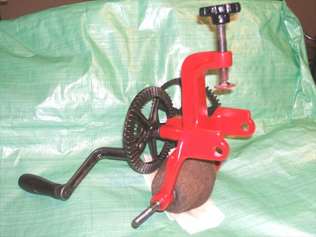

I purchased this at a local Flea Mkt a while back. It was seized up and required a weeks soaking in vinegar. The stone was soaked in Kerosene and cleaned. Nice little grinder.
After reassembly I realized the kerosene was still seeping out.
Fugi Digital in my shop.

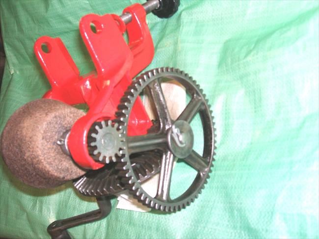

Other than cleaning and new paint I replaced the cotter pins where nails had been used. I had to drill out the old cotter pin that secured the stone to the arbor.

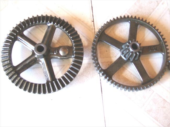

Wheel parts L2 and L3. The body is L1 and the hand wheel crank is L4.

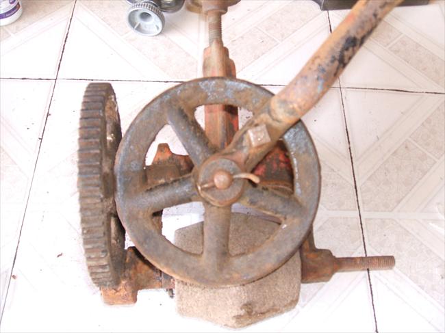

As received.
As received.
