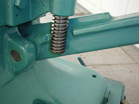

The machine was in generally good condition when I bought it but the foot pedal shaft had been previously welded and rebroken before it came to me. The break was right at the point where the upper web is cut out to allow the table raising screw to pass by. I fixed it with a combination of welding, brazing, and a mechanically fastened steel splint.

Area of the foot pedal shaft that had previously broken. The splint I added is the bump on top.
My Coolpix
Another view of the repaired pedal
My Coolpix
