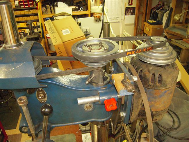

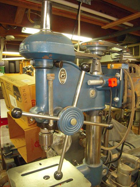

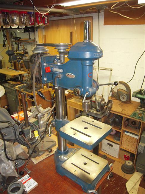

Sears Master Craftsman 15" bench model drill press, built by Atlas Press of Kalamazoo Michigan.
I partially disassembled the machine to lube the moving parts, adjust the return spring and clean the column.
The head, table and quill coordinate clamps were jammed in their bores, so I sanded and filed the outside diameters to a smooth fit.
A previous owner installed hand tighten accessory knobs over the original motor mount adjustment bolts. They work so well that I left them.
The original belt, chuck removal wedge and key were included.
I added the Atlas intermediate pulley for low speed operation.
I also added a 1945 Craftsman 1/2hp 1750rpm motor, model 115.5829.
I reworked the motor cord wiring.
The hot lead loop cord comes out of the original toggle location in the base and has a two prong female plug.
The switch cord from the head is equipped with a two prong male plug.
This allows me to easily separate the motor from the drill press, as needed.

Left side full view (sorry for the clutter). The SKF bearing decal is nearly gone.

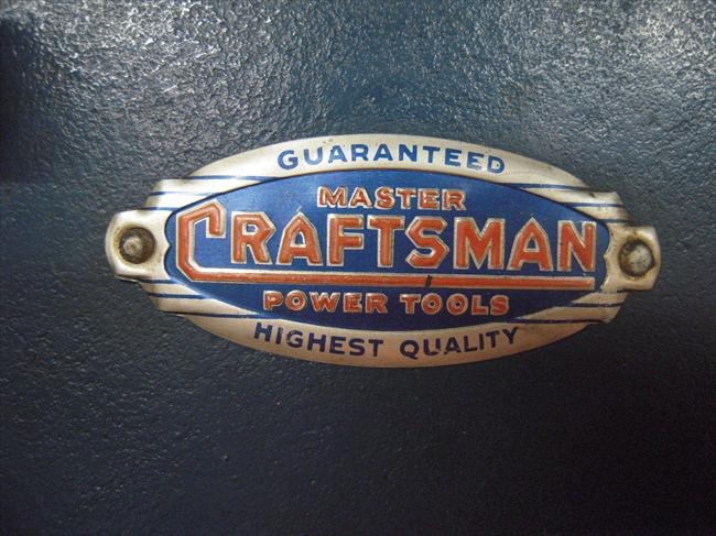

Tag

Right side of head. Hanging from the motor mount is the ORIGINAL Altas labeled belt.

Intermediate pulley. My quick and dirty ho-made chuck key holder attached to motor mount.
Nikon CoolPix with flash
Pulley guard
