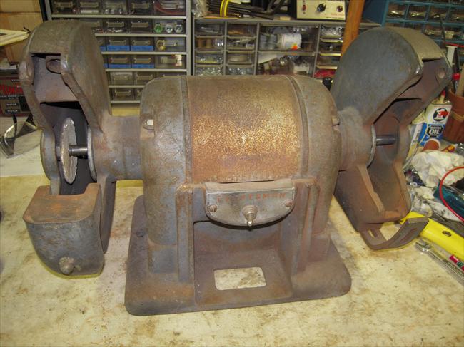

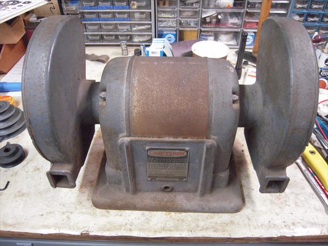

The grinder is missing the quench tray, eye shields, light bulbs, RH tool rest, outer flange and nut.
The wiring also needs attention.

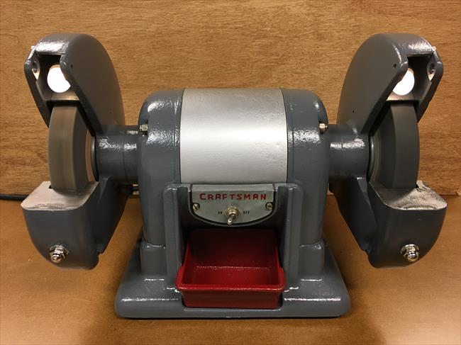

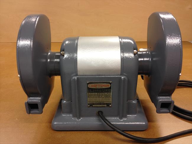

05/28/2016: Completed assembly
Added ½” x 18 gauge steel machine bushing between each shaft shoulder & inner wheel flange (die-cast aluminum inner flange was deforming around shaft shoulders).
HPN for lamp cords, wire nut & tape at lamp sockets for future disassembly (21” rough length for each lamp).
Used 8-32 x 3/8” stainless steel machine screws for outer guard attachment, 9/64” hex socket.
Replaced centrifugal switch hardened wires with new 14 gauge.
New 5/16-18 x 1” carriage bolts with added USS washers on tool rest arms.
Original 5/16-18 x ¾” carriage bolts with added SAE washers on tool rest attachment to arms.
Installed newer 14-3 power cord, ground to eyelet on capacitor attachment bolt.
Used GE 76422 LED 0.5W candelabra base 2800K bulbs.
Added generic rubber feet to 4 corners (originals missing/destroyed).
Tested with undressed 7”x1” wheels – runs well (should be much smoother with dressed wheels.)

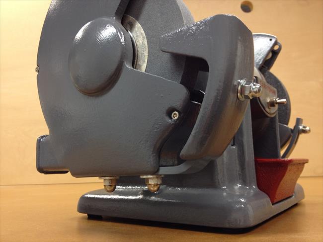

UPDATE 3/23/2017:
Obtained a tool rest from a fellow OWWMer.
Original tool rest chrome plated brass acorn nuts were starting to yield.
Replaced tool rest acorn nuts with zinc plated steel and 7/8" long carriage bolts.

Front view, as received.
Nikon CoolPix with flash
Rear view, as received.
Nikon CoolPix, existing light

(After) Front view while running
iPhone 6S camera-existing light
(After) Rear view
iPhone 4S camera-existing light
(After) Left view
