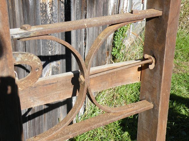

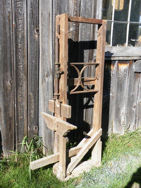

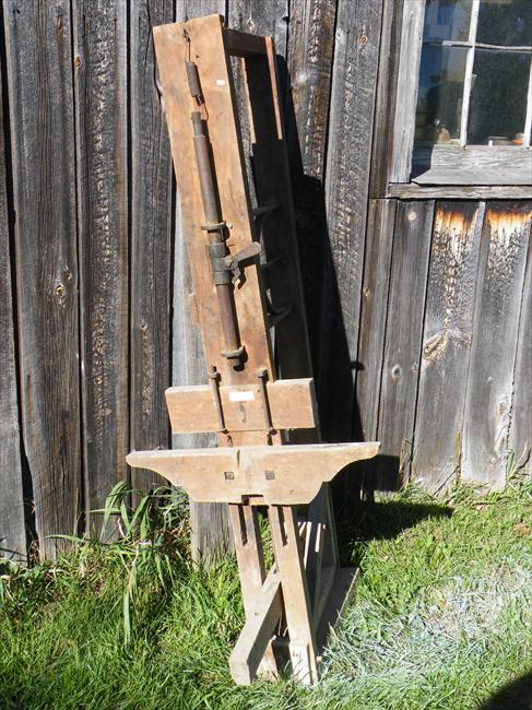

This machine came from a local auction sale in the early '80s. It has been sitting in my barn ever since. I attribute it to E E Abbott because of its proximity to Gananoque. I don't have enough examples available of Abbott machines to confirm the attribution. There are no castings in this machine. It is all wood and wrought iron. I do know that Abbott used a lot of wrought iron parts in his woodworking machines. It looks like it was inspired by the mortisers of J A Fay from the same period and earlier.
The working principle is the same as J A Fay's patent.
Photo by Art Shaw
The return spring would be a board fastened to the ceiling. It is missing and someone has attached the totally unsuitable coil spring.

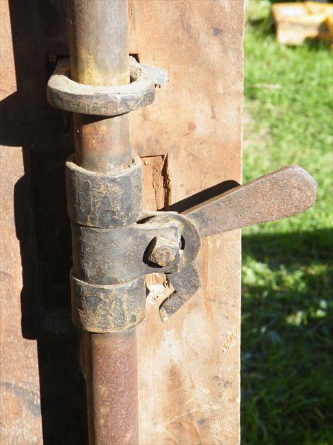

All the parts are forged.

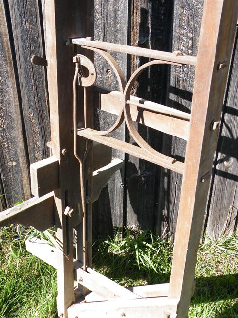

The wing nut at the back adjusts the chisel in or out to accommodate the thickness of the wood.
