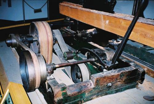

This is where it all begins---Tree into lumber. T.H. Ricker saw mill on static display at the Maine State Museum in Augusta Maine. Cone pulleys on left give three speeds of feed. Lever gives forward and reverse motion to the carriage. Forward motion is given by pressing the small friction pulley seen on the right end of the feed shaft against a larger iron pulley which transmits power to a pinion which meshes with a rack of gears on the underside of the carriage. A loose belt on two flanged pulleys gives reverse motion to the carriage when the belt is tightened via the small arm mounted pulley attached to the feed lever.
