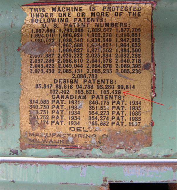

Dating attribution (1937) is based on patents decal, name plate, and lack of a serial number. The most recent patent listed (D105,429) was granted Jul. 27, 1937, so unit was produced sometime after that date. OWWM Forum discussions suggest Delta Triangle name plate style was used from Oct. 1935 into 1937, but often with the caveat that dating is approximate. Serial numbers only began to be assigned ca. 1940. (Later: more review OWWM forum indicates the motor is somewhat later - Delta-Milwaukee trade mark, ca. 1941-1954?).

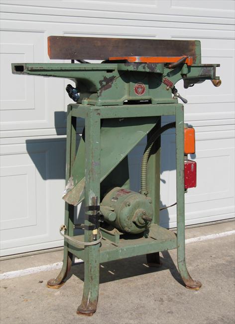

Front view
personal camera

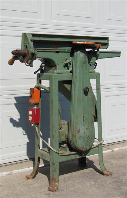

rear view, incld. belt cover
personal camera

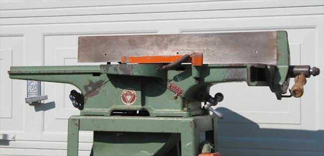

front, closeup, incld. couple replaced handles.
personal camera

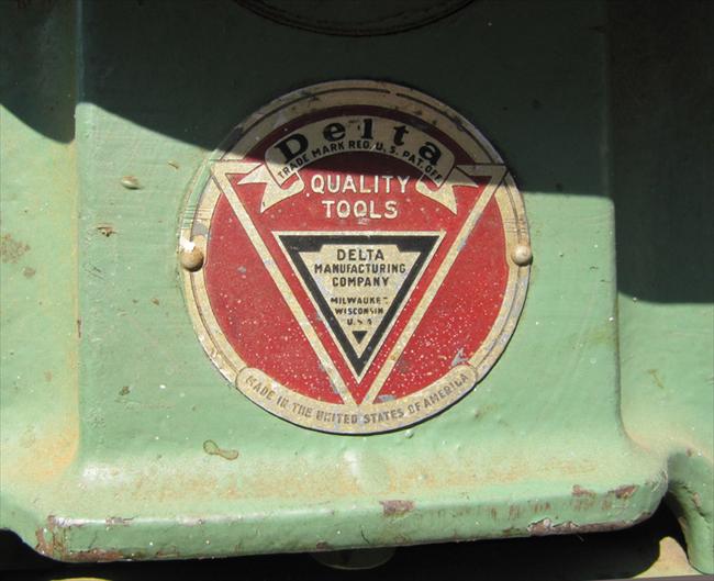

"Delta Triangle" name plate on jointer
personal camera
Patent decal; most recent patent marked (granted Jul. 27, 1937)(
personal camera

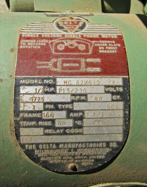

Delta motor plate (made by Mararthon Electric Mfg. Corp.)
personal camera
