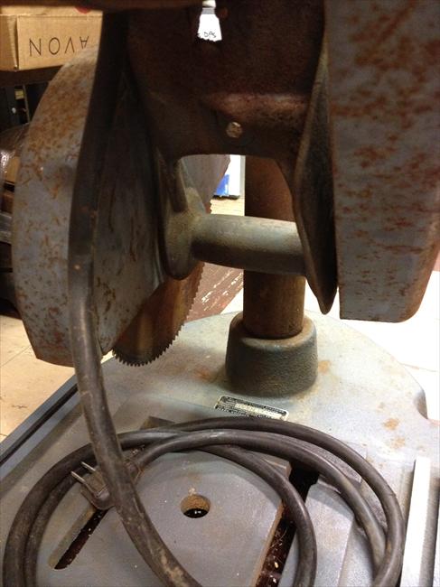

Sears Craftsman Swing Saw, built by the Central-Specialty division of King-Seeley, in Ypsilanti Michigan.
The saw is predominately composed of iron castings, and very heavy.
The base is nearly identical to the same era floor model drill presses, except for the added mounting slots for the wooden work table (which is missing).
This saw is equipped with a 10" blade and ¾hp motor. A 12" blade may also be used with a 1hp motor.
The blade arbor is ¾" with LH threads.
Both vee pulleys are 3" diameter machined cast iron, for use with a 3450rpm motor.

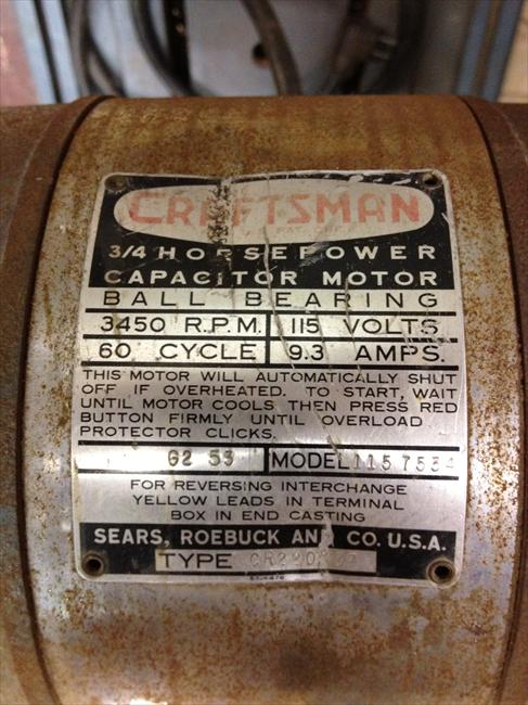

The motor is a ¾hp, 3450rpm Craftsman, built by Packard Electric, in 1953.
A steel combination blade was original equipment. This is a replacement blade.
A steel spacer bushing between the arbor nut and outer flange is removeable to use a dado blade.
I ran the saw briefly and it is very smooth.
I plan on cleaning it up a bit, making a replacement table and using it for crosscuts.

Switched to Craftsman 113.19060 1hp 3450rpm capacitor-start motor, rewired for 240V operation.

Comments: As received
Source: iPhone camera, existing light
Comments: Badge, miter scale, miter lock handle on the right
Comments: Pull handle is wrapped aroung the ball bearing arbor
Comments: ¾hp motor, built in 1953
