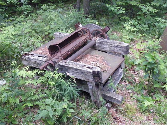

The first time I saw it

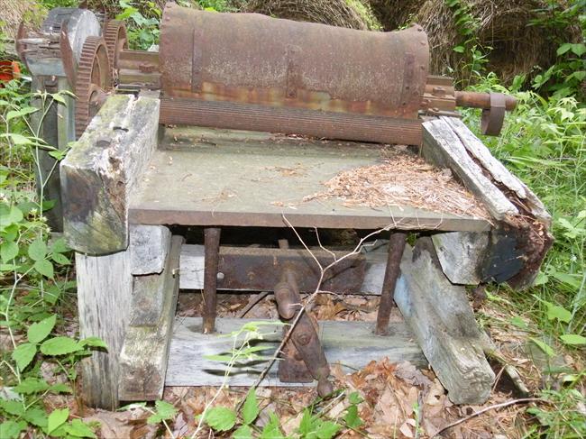

See the wooden wedges under the corners of the table, and the hand wheel that draws them forward or back

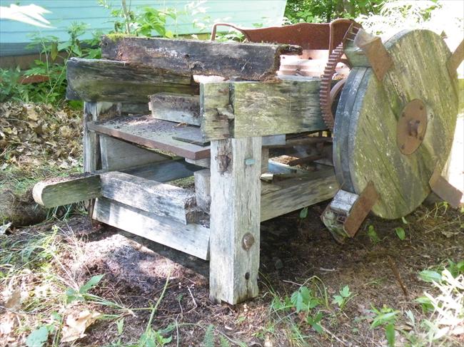

My second visit, after I raked away the leaves and pioson ivy. The big wooden pulley is on the feed drive.

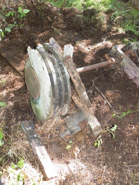

The remains of the jackshaft were nearby.

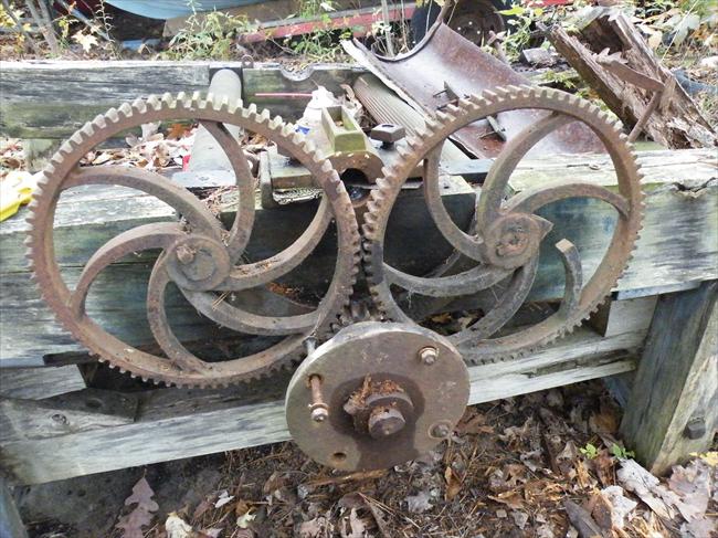

This is the drive arrangement for the feed rollers, with the big wooden pulley removed

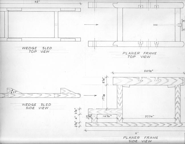

This is part of the drawing I made to show how I think it went together.
