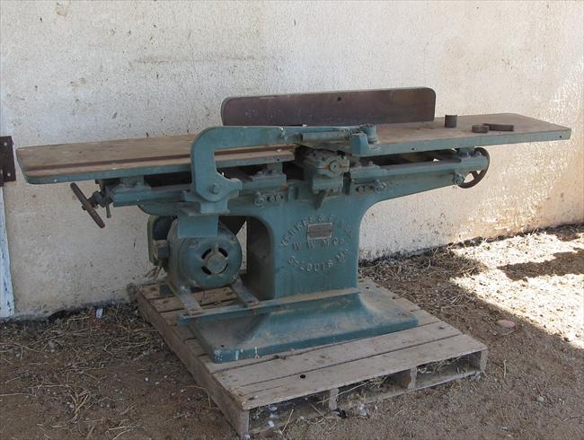

The machine was advertised on Craigslist. Unused for a number of years, it had been sitting for a while outside under an awning, where the pigeons were able to pepper it. Overall in excellent condition. Obviously repainted at some point, but they did an OK job. There's a Dept. of Interior (BIA, probably) property tag on it, currently covered with paint. Master Electric Co. 3hp-3ph motor and mount (not original, this was a line shaft machine). The 4-knife round head has Crescent Co. markings. Babbitt bearings seem sound. Significant surface rust on the tables, but believe it will clean up OK.
As found. The motor and mount are not original

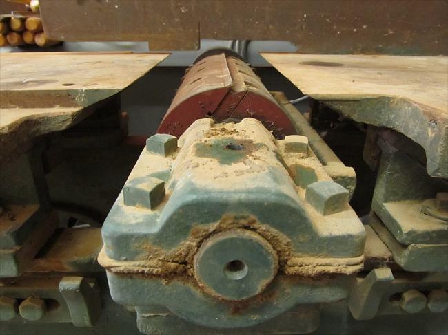

babbitt bearing housing and non-original 4-knife Crescent head

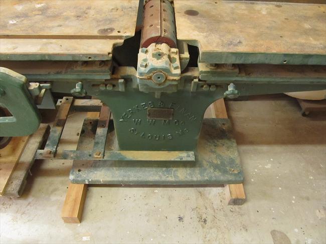

It should clean up nice
