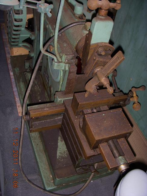

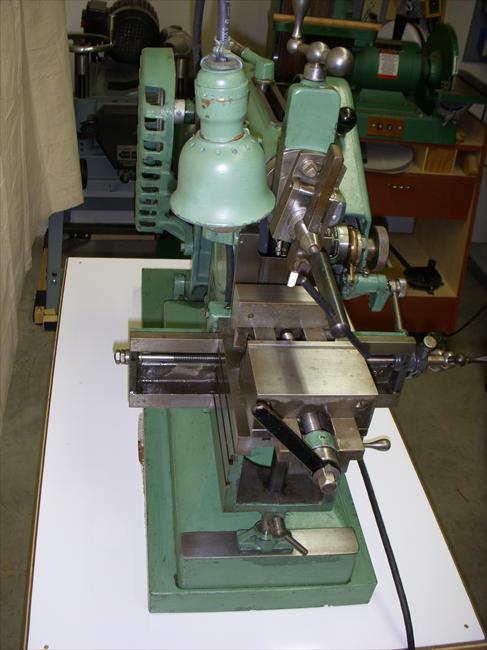

Picked this up last year at an estate auction (http://owwm.org/viewtopic.php?f=77&t=105770) and finally got around to it last week. When I brought it home everything was frozen in place. Luckily, most of what looked like rust turned out to be a gummy coating of oil, sawdust, and tar (the tobacco kind) that acted as a preservative. She cleaned up readily with a razor blade, small wire brush, kerosene, and simple green. After disassembly, cleaning, and re-wiring it’s running and making chips. I considered a full-up repaint/restore but, given its war provenance, opted to keep it as original as I could retaining the top coats of paint and its original “Hart and Hegeman” rotary switch (which predates the machine by at least a decade or two). It appears to have had limited use.

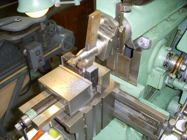

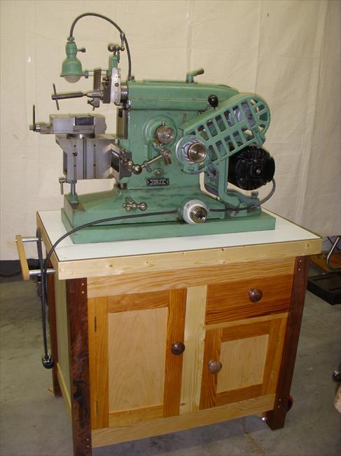

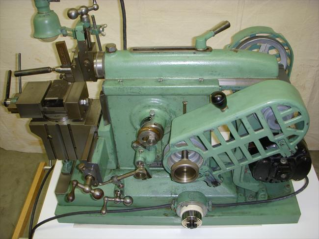

The serial number is SH943620 which, best I can figure, places it around Aug-Sept 1944. It has its original vise, the War Production Board tag, Delta work light, and the rotary switch. I even think the belts are original (still functional) but will be changed at a later date. The 1/3hp Sunlight Electric motor also appears to be original to the machine. Since it didn’t have a stand, I made one for it that’s a close approximation of the original. It was made from scrap construction lumber (top and framing), pine recovered from a dumpster (doors and drawer), and some left over walnut from a chair project. I have to say I’m as happy as can be with it – it’s a great addition to the shop and I can’t wait for the first project (a part for an Atlas mill that’s next in the que).
As purchased at auction

After cleaning and with new cabinet
Side view, note the roatary switch and War Production Board tag lower center

Full frontal view, original vise and Delta work light
