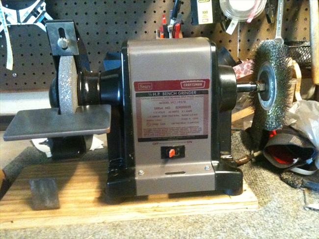

I bought this grinder on eBay in June of 2012. I dont know any history on this grinder, the PO was an in-between seller. the grinder was in fairly good nick. the left bearing is a little crunchy and the aluminum and steel are both corroded. i plan on stripping and painting the body and replacing the bearing (maybe bearings) but the wiring is in really good shape. it looks as though the PO re wired the plug and maybe rewound the motor. the badge is really faded but luckily i know the secrets of photoshop and coerced the type out, then in Illustrator i recreated the badge to its former glory. it is missing both eye shields and the left guard. i really don't mind about the guard because i plan to use the left side with a wire wheel, i will eventually remake or find the eye shield. i also am going to re make the tool holder out of 1/4" plate steel with so it surrounds the front of the wheel instead of just the front of it. it also came with original Craftsman grinding and wire wheels.
update: 7-9-12 finished the restoration in no time. i had to replace the bearings and the rubber feet. i replaced the feet with 5/16" double stud rubber vibration mount. there sold by Reid Supply Co. part # vm-50. i also fabed a tool rest from 1/4" steel plate. i have the eye shield and is waiting to be painted and installed.

refurbished front of grinder
photo via my iPhone

before pic
pic via my iPhone
fabed tool rest out of 1/4" steel plate
pic via my iPhone
