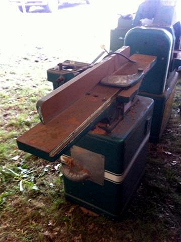

Looks like it has been sitting all this time with very little use. It is wired for 220. I plugged it in and it keep tripping after running for 15 seconds.. Replaced with higher overloads. Still did it? Opened up the motor wiring box and the motor was wired wrong.Reconnected properly and she runs great! Probably why it didn't get much use in the school....
