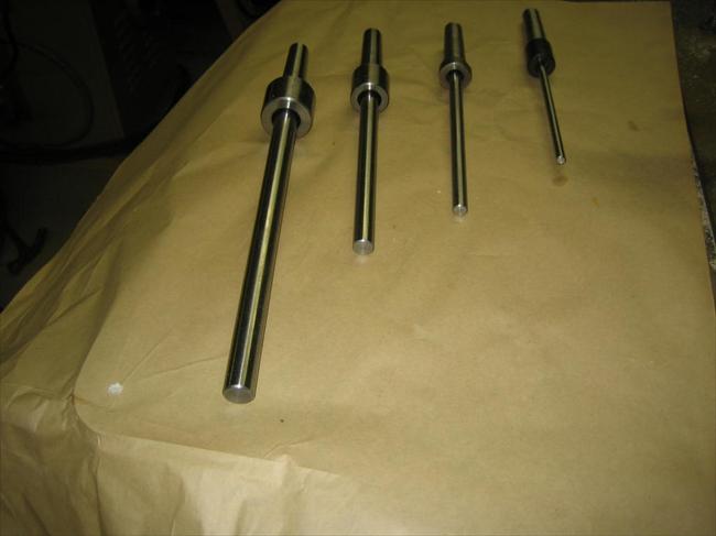

The spindles turn at 1750 RPM and there is a lever on the side to engage and disengage oscillating feature. A 1 HP 1750 RPM Peerless Electrical Company motor drives the spindles. The spindles use the Morse # 2 tapper to attach to the drive system. The sander came with several spindles and throat plates. I had to have additional spindles made to complete the full complement of spindles sizes. I made the table mounted under the start switch box to hold the spindles.

Comments: MT #2 Spindles I had made for this sander
Source: Edward Kantor May 2012
