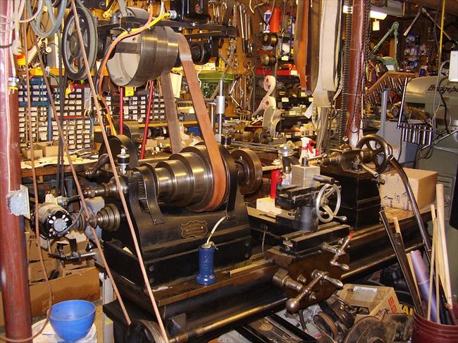

View showing overhead belt drive{fastened to house main beam.as belt stretches I move the lathe a little to maintain tension

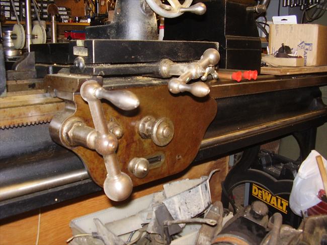

close - up of simple apron with slide {worm} engagement slot,and clutch tension knob above it..
