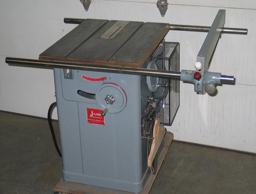

After photos of a restoration of questionable value. The saw runs smoothly enough with its 1.5 HP motor, but still not a lot of power. Fence is a modified Powermatic. New bearings (5204 & 6204 snap ring) , all parts wire brushed. Pulley turned true again. Nut is 5/8-8 LH, Single pulley on motor using a 24 in. belt. New inserts. Delta miter gauge. Tool rack on RH side. New plastic motor cover. Saw was restored for my son who has little space for a saw now. Fence rails tilt up to accomodate storage. Mobile base to be added later. No place for a guard or splitter. Insert design is flimsy with a .010 thick rim held at back with a screw. If you should find one of these saws needing extensive work, look elsewhere.
Saw with fence extensions raised for storage
my camera
Saw with extensions in place ready for sawing
my camera
Left side showing plastic cleanout door.
my camera
