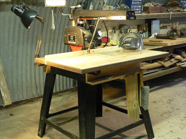

Left view of saw ready for use

Overall view from left, showing legs and added tool shelf, chich hides the serial number plate unfortunately

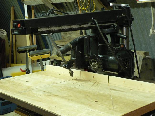

Overall view from right

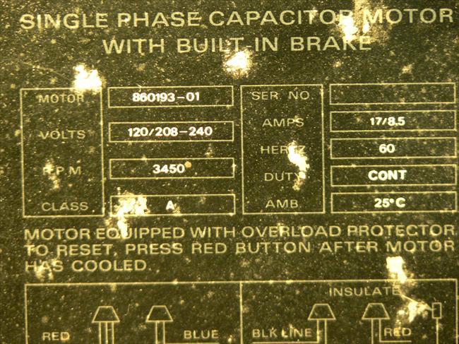

Motor plate. Saw serial number plate is hidden by the tool shelf
