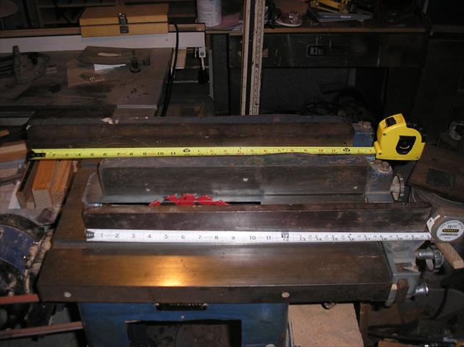

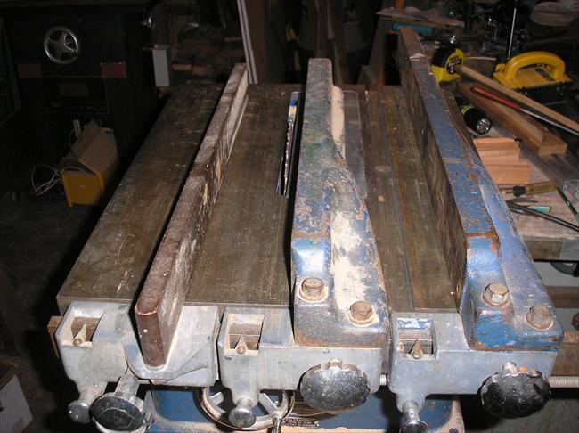

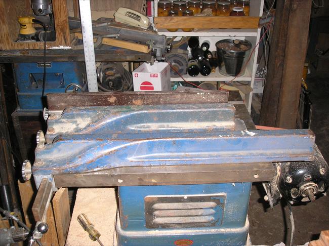

I am adding this here mostly for archival purposes. The five fences shown represent the three chief versions of the fence available on these bench saws. The symmetrical one is generally thought to be a later/the last iteration. The other two cast fences are the 8/9" and the 10" versions. And the second-to-last photo shows the maple sacrificial fence used on saws equipped with the table extensions. The ruler lines on the (longer) fence rail won't line up with the blade without a half inch sacrificial face.
view of fence heads
own photo
side view 1
own photo
side view 2
own photo

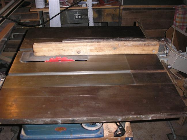

fence for saw with table extensions
own photo

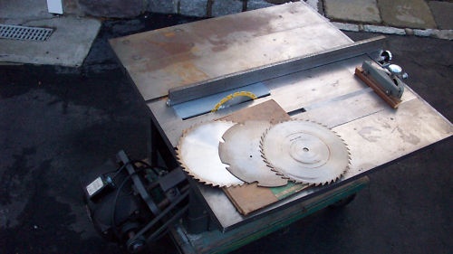

longest version of all
ebay
