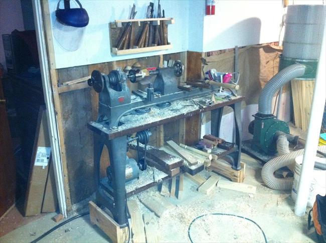

My dad bought this at an auction in the 90's but never got into wood turning. It came with all sorts of accessories including about a dozen chisels, several face plates, a huge 4-jaw chuck, a steady rest, double-wide support (with second banjo), head/tail stock risers (with 3rd, taller banjo), jack shaft for 325-9000 RPM, original duro motor and the original stand. Unfortunately the motor burned out shortly after I started using it.
This machine now in my basement and I taught myself to turn on it. After a month or two I added some risers to the stand which are laminated pine attached with 4 lag bolts. Now I can turn for more than 30 minutes at a time without back pain! The head stock thread is 1"-16 TPI which doesn't seem to be very common. I ended up getting a MT2 with a standard thread so that I can use modern chucks.

Front of machine

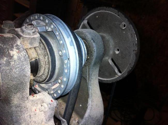

The clutch mechanism from behind. The black line going into the pulley is a big rubber cone which is moved back and forth by a handle. It works decently but does leave something to be desired.
