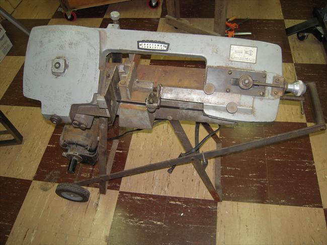

Sears Craftsman metal cutting convertible band saw, built by Atlas.
Capacity: 3" x 6"
Blade: ½" x .020" x 60" Speed: 135 FPM

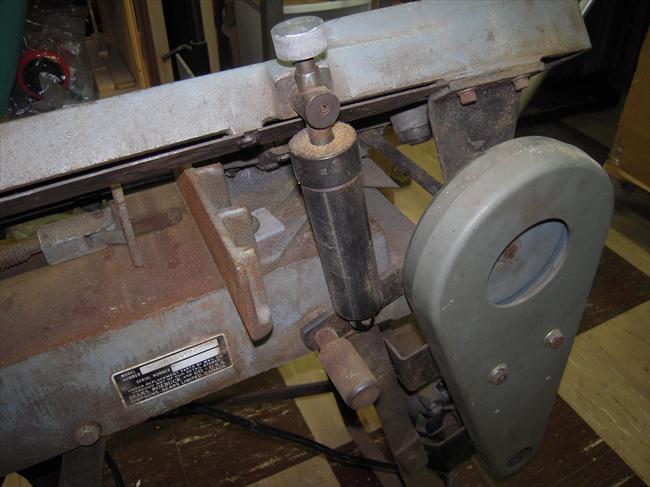

Horizontal cut with variable feed rate shock absorber and automatic shut off.

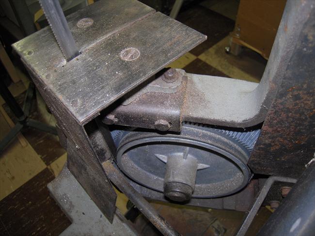

Vertical cut on small table face.

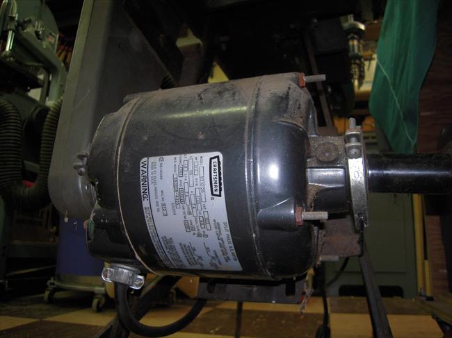

Motor: Craftsman/Emerson 113.12120 ½hp, 1725rpm, split phase, sleeve bearing motor.
As purchased

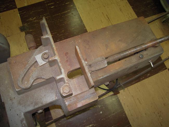

Quick action vise

Feed rate shock and fiberglass belt guard

Vertical saw table, bevel gear drive

Motor
