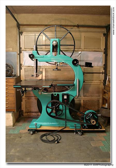

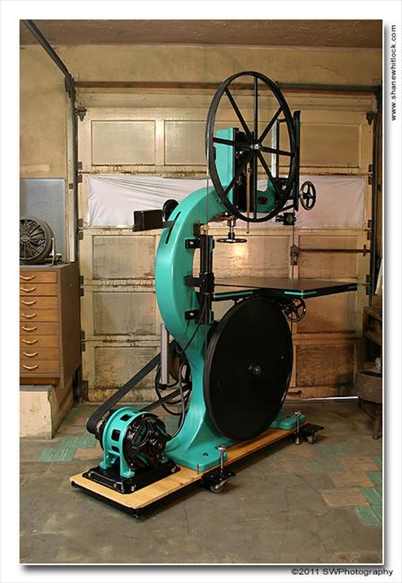

Enterprise Manufacturing Co. 36 inch Band Saw
Saw Specs:
Manufacture - Enterprise MFG. Co. in Columbiana, Ohio
(no serial # or model # stamped on badge or anywhere else on the saw).
Wheels - 36" by 2". Upper wheel is spoke. Bottom wheel is solid cast iron.
Main Table - 30½" by 36½", tilts to 45 degrees.
Axillary Table - 15½" by 19¼".
Blade Length - 223½"
Blade speed - 4,244 sfpm.
Cut Capacity - 18" resaw and 35½" between C-frame and blade.
Blade tension is provided by spring and counter weight.
Wheel pulley is 14", also made by Enterprise.
Overall height of the saw is 96"
Weight of saw with motor approximately 2900 lbs.
Motor Specs:
Manufactured by Westinghouse
3 phase 5 h.p. induction motor
220 volts 13 amps 1740 rpms.
Motor pulley is 3"
Mobile base with leveling screws measures 31" by 67".
Purchased for $100
Restoration photos can be viewed here:
http://www.thepatriotwoodworker.com/forum/topics/enterprise-band-saw-restoration-complete-bandwidth-warning-16
(ya may have to join but its free)
Entry posted here showing before restoration pics can be viewed here:
http://vintagemachinery.org/photoindex/detail.aspx?id=12792
