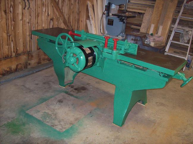

Preston Woodworking Machinery Co., Ltd.
Preston (now Cambridge), ON, Canada
Machine Type: Jointer
Machine Size: 16"
Submitted By: Lawson Bell
Description/Model: 16" Jointer
Date of Manufacturer: 50's or 60's
Last Updated 12/10/2011 5:17:07 PM
This machine was purchased from the CNR main shops in Moncton NB with several other pieces of heavy duty woodworking equipment.
Speculate that vintage is 50's or 60"s because of greaseable cutterhead and motor ball bearings.
3, 3/16" HSS blades in good condition show machine was not abused. Very significant piece of iron, Leg and frame castings are 1/2" thick.
Comments: Original guard missing. Infeed and outfeed table ways and all adjustments are well designed and operate easily.
Source: Lawson Bell
Comments: Not original colour
Source: Lawson Bell
