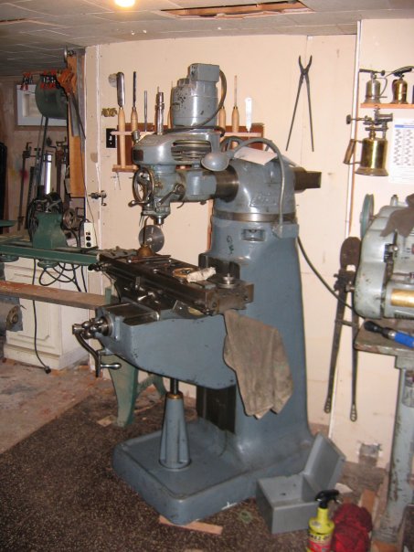

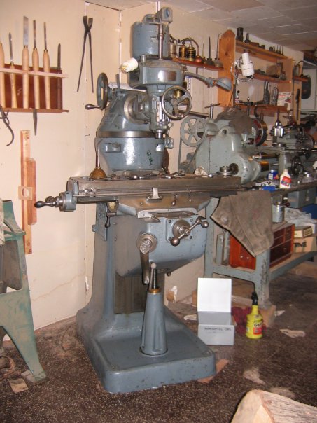

I picked up a phase converter for it and a few assorted endmills. I also scored a collet set for it on Ebay.
It has a 1HP 220V 3PH motor & accepts #7 B&S taper.
I have now completed my shop & it is a great feeling!
without the powerfeed assembly re-installed.
Using it for broaching the keyway in a sheave.

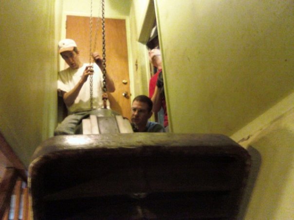

Coming down the stairs-- I installed a hiost point to to the stairwell ceiling joists & used a 1 ton chainfall to get in in there. We attached two 2x4's to the stair treads & slid it down on it's back.
