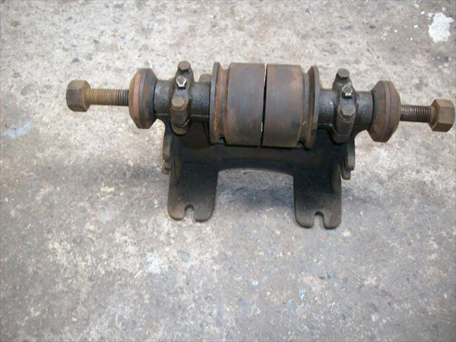

I picked up an old belt drive grinder a while back and decided to get around and restore it.
From researching the site, it looks to be identical to a couple of grinders I’ve come across that were branded as Dunlap and sold thru Sears in the late 30’s-early 40’s.
The Dunlaps I've seen were painted blue and had a Dunlap decal on them. When I cleaned this one up it seems it had been painted gray and black and there was no evidence of a decal. It might have been repainted at some point or might have been painted and branded differently and sold thru some other retailer. I’ve spent a little time trying to find out who actually manufactured these but no luck so far.

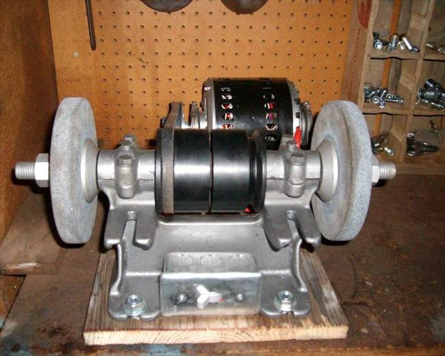

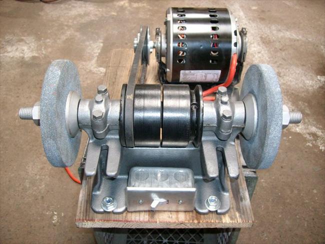

Set up and ready to go.
As received. In spite of the way it looks the babbit bearings are in good shape and it just needed a good cleanup and a bit of adjustment on the shims.
The grinder could be run from either a V Belt or Flat belt. If run from a line shaft, the screw from either pulley could be removed turning that pulley into an idler (loose) pulley.
