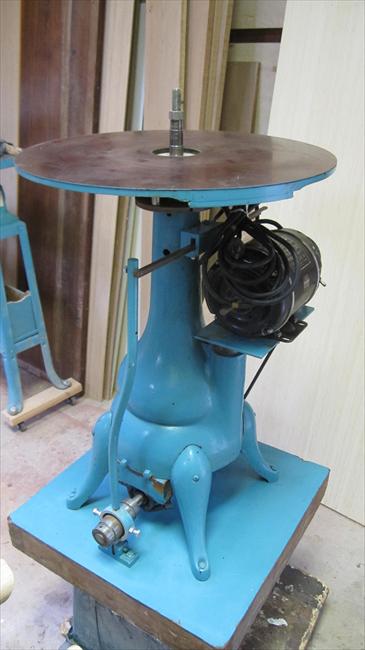

Acquired from a retired NIST scientist in 1992 in Boulder Colo
[2015-07-06 admin note: this was identified in an owwm.org discussion as a modified Albaugh-Dover cream separator! Thanks to Kent Baker for making this connection.
http://www.owwm.org/viewtopic.php?f=1&t=127435 ]
Comments: I have several omni directional cutters for this shaper

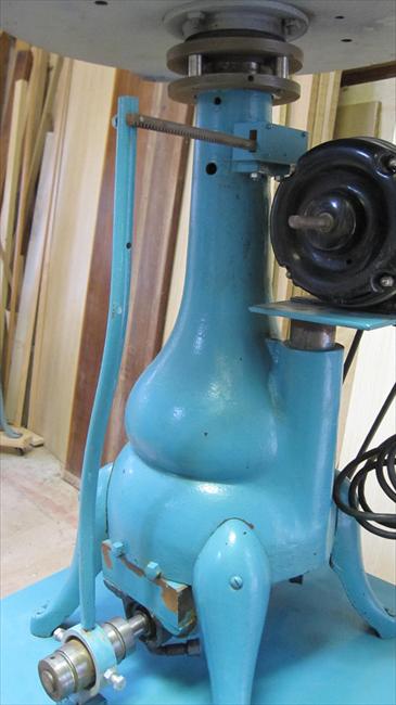

Comments: The bar can be moved one way or another to change spindle rotation

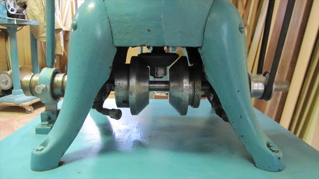

Comments: The drive shaft moves left or right engaging the spindle shaft . Right = clockwise rotation / left = counterclockwise rotation . Note hand packed grease fittings with caps to force gease into bearing

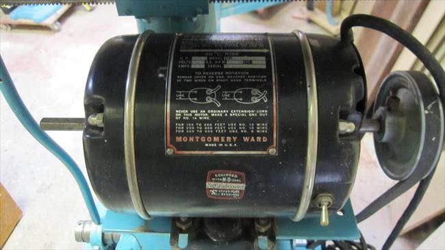

Comments: 1/3 hp split phase motor probably not original
