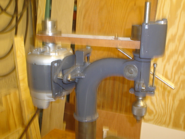

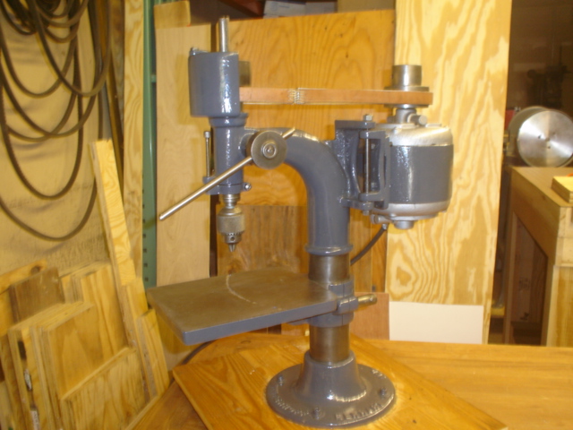

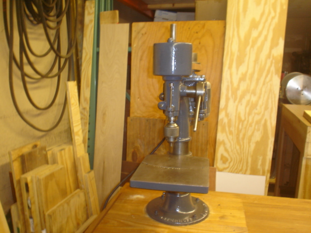

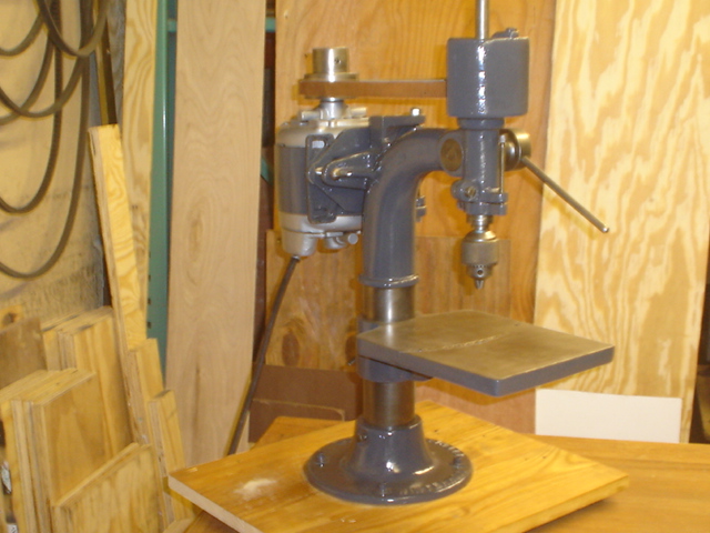

THIS IS THE WINTERHOFF MODEL No.0 MOTOR DRIVEN BENCH DRILL
MACHINE SPECIFICATIONS:
OVERALL HEIGHT ..... 25.5"

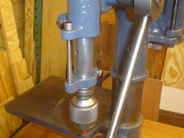

CHUCK ..... 3/8" CAPACITY
QUILL TRAVEL ..... 2"
CENTER OF CHUCK TO POST DISTANCE ..... 5"

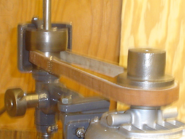

THE DRILL PRESS IS POWERED BY A SINGLE PHASE 220 VOLT AC 1/4 HP ROBBINS & MYERS MOTOR WHICH OPERATES AT 1750 RPM
POWER IS TRANSMITTED FROM THE MOTOR TO THE SPINDLE BY A 1" WIDE LEATHER FLAT BELT ON A PAIR OF 2 STEP FLAT BELT PULLEYS GIVING THE OPTION OF 2 SPEEDS
THE TENSION OF THE FLAT BELT IS SLACKENED AND TIGHTENED BY LOOSENING OR TIGHTENING A THUMB SCREW ON THE MOTOR MOUNT DEVICE
THIS RESTORATION WAS DONE BY AMERICAN MACHINE OF SHELBY NC
