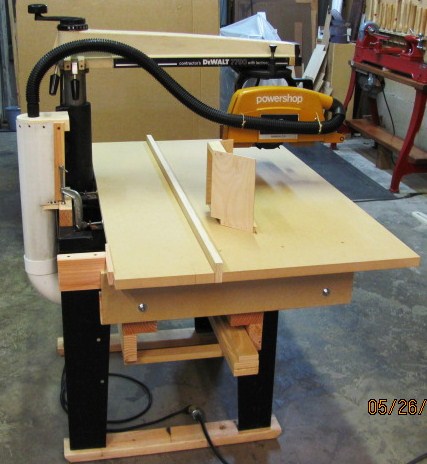

5/31/2011 11:28:05 AM
1980 tri-color with wide legs, found on craigslist from original owner. Garage kept with owners manual(MAR80). Pulled carriage bearings & cleaned, scrubbed painted surfaces. Original bearings & wiring still good. Built a white pine outrigger and bolted it to the underside of the frame. Rigid & adjustable, it will help hold the wide top flat. Top is 49" wide 1" MDF. Blade guard airflow empties into the dust collector hood, sawdust deflector assembly removes for access to the center cleat thumb screw. All adjustments set before making the first cut into the new table top. Six photos.
49" wide top
the happy owner
sawdust deflector removed
(4) 40" 2X4s = two angle supports
extra table fences underneath
cleat stop for fence and spacer boards
25" on left side of blade
