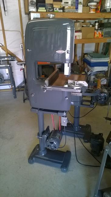

Ealry 1950's Craftsman/King-Seeley Model 100 12" Band Saw on cast pedestal stand with 1/2-HP motor
C. Garrett

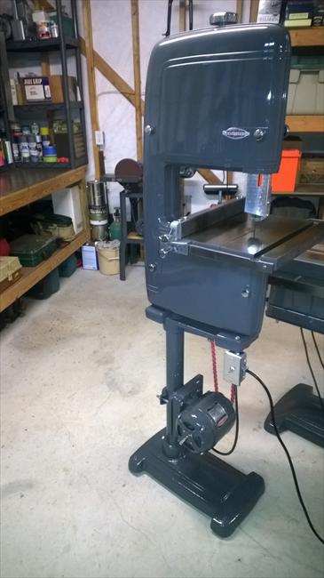

Craftsman/King-Seeley Model 100 Band Saw
C. Garrett

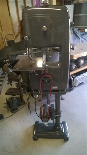

Craftsman BS rear view showing Fenner link belt on Browning cast iron balanced 5" arbor pulley.
C.Garrett

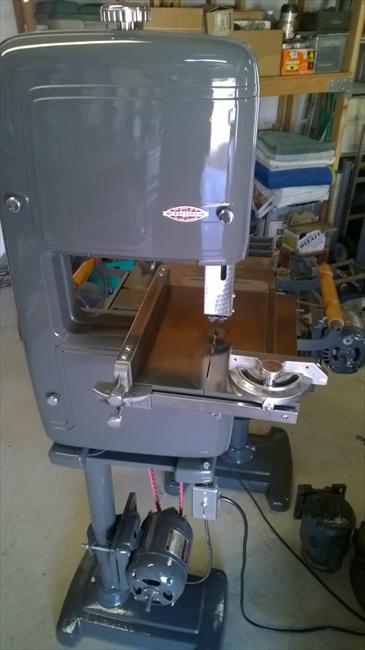

Veiw showing optional Craftsman rip fence and miter gage.
C.Garrett

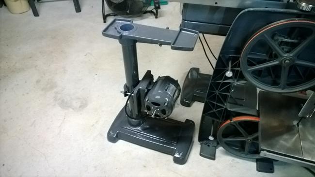

Craftsman Model 100 BS cast iron pedestal stand with 115.Packard 1/2-HP 1750 rpm motor after restoration (Model 100 BS next to it)
C.Garrett

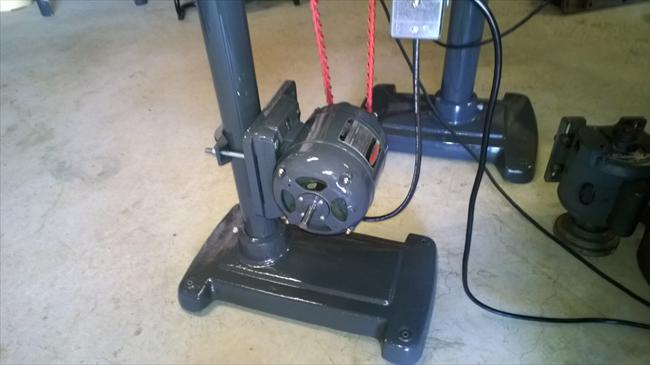

Craftsmans-Packard Electric 1/2-HP 1750rpm original motor/pedestal stand view.
C.Garrett
